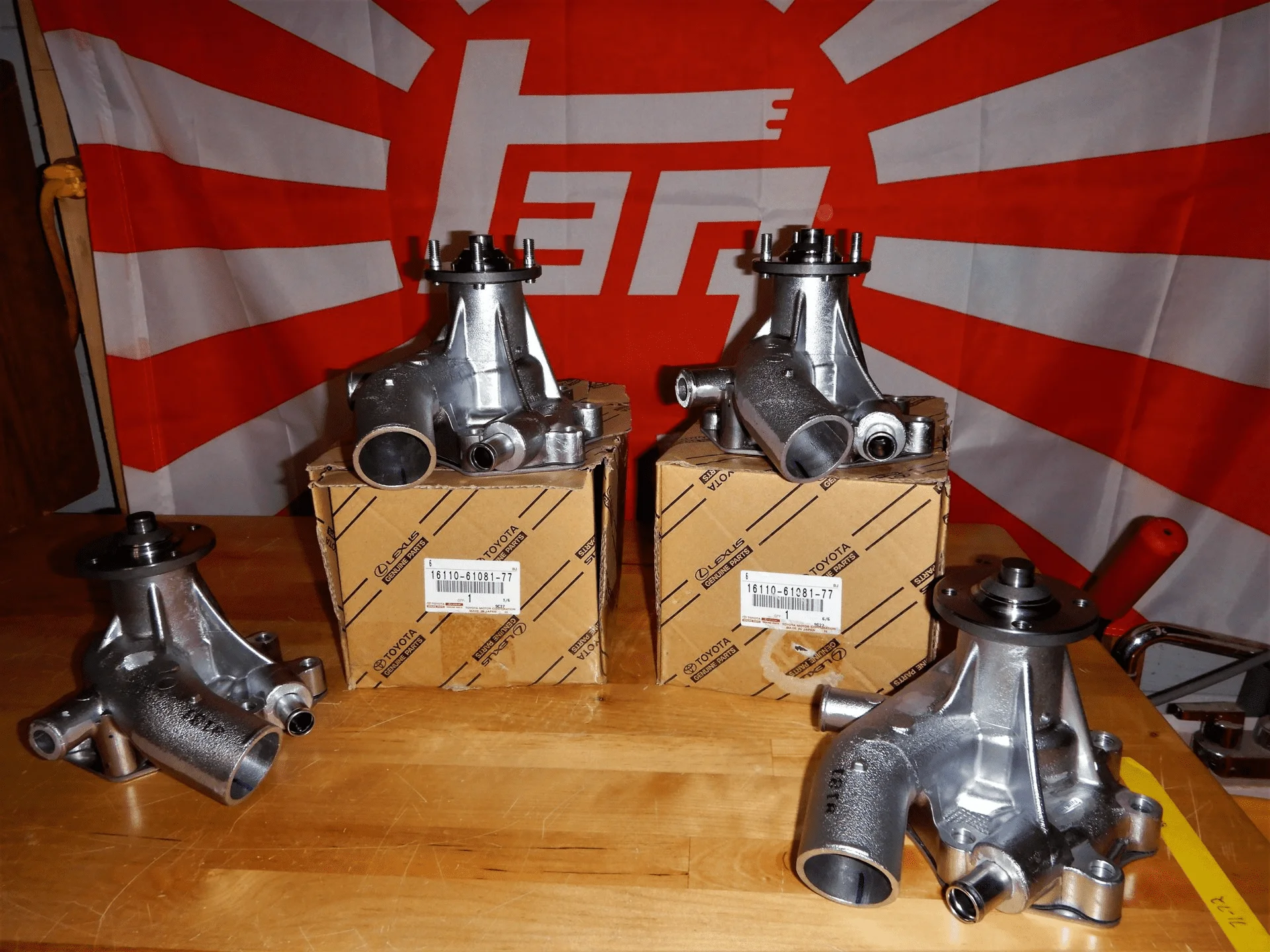

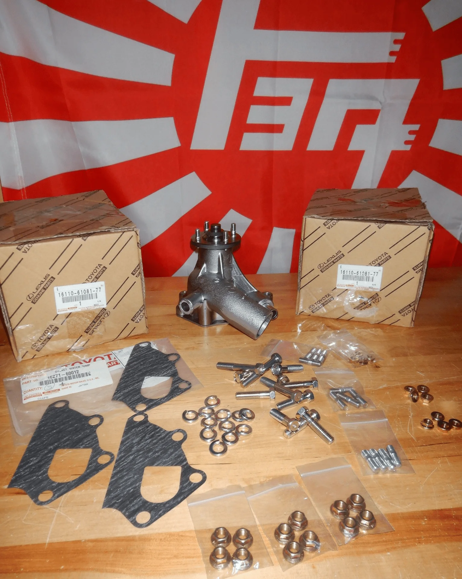

the key to a successful water pump repair is a OEM pump toyota
all new mounting hardware
and black FIPG the heck out of all 6 sides of all face contact parts including fasteners
never a leak will be your next thread

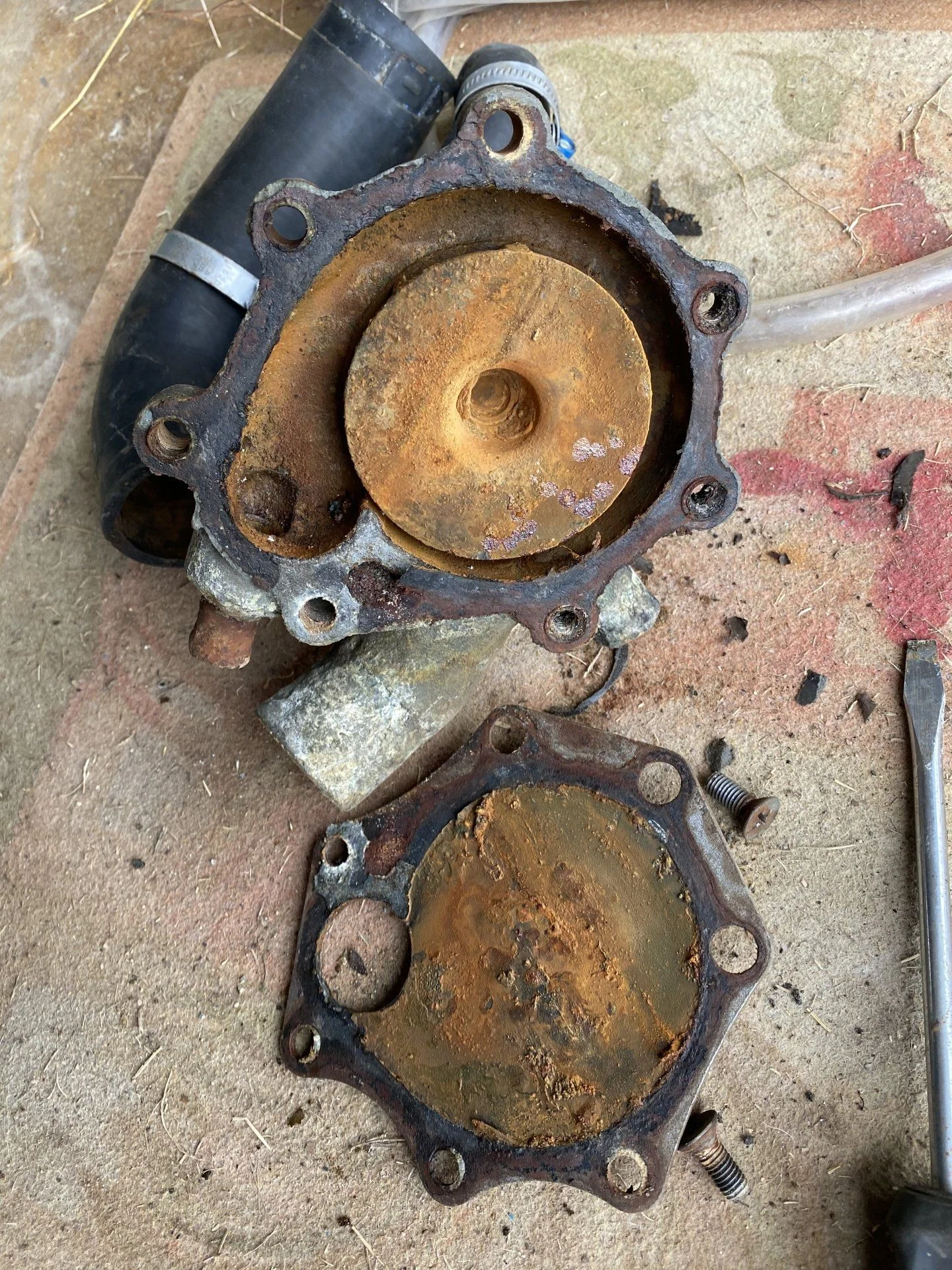

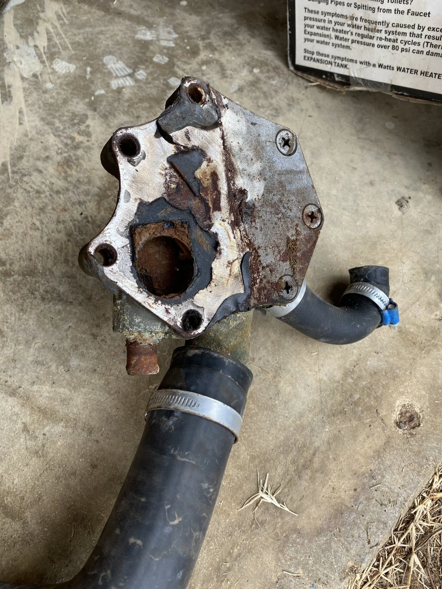

I definitely could have used a thread dedicated to 2F water pumps. If this helps anyone here goes....(I would have taken pics but will try with detail. What I came up with is a result of what I researched, read from other threads here or just had to use some outside box thinking.)
I didn’t have a means or tool to keep the belt from slipping even when I put the belt back on, so I tied the belt together in the middle and was able to loosen the bolts. Removed hoses. Removed radiator.
The bolts from pump to engine were rusted. I cleaned any grease and dirt from around the bolt then used BP Blaster and let sit for an hour. Ended up needing to use impact driver to break them loose
Will continue tomorrow...
