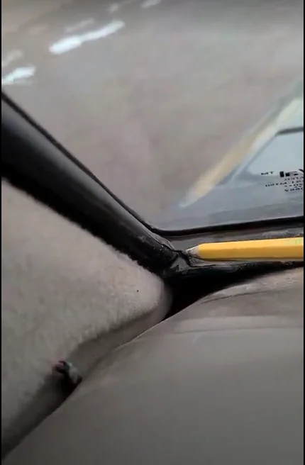

Here's where water was entering my cab around the windshield molding. Then it ran along the firewall or kick panel onto the floor. As stated already, pull the rubber plug on the floor and let the water drain into your rocker panel. Make sure the rocker panel is able to drain the water out of itself and not clogged by debris.

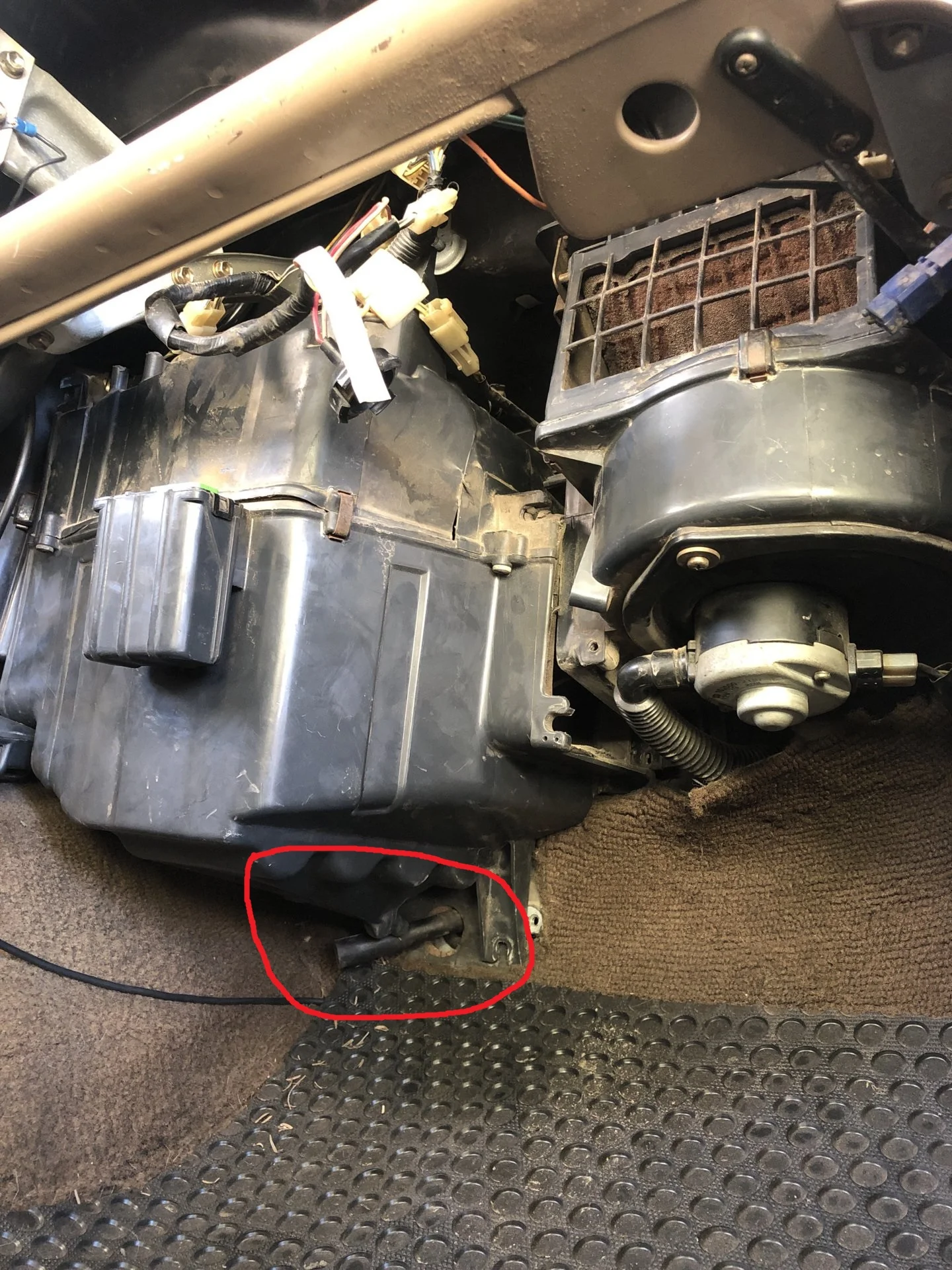

I've had water on my passenger side floor/soaked carpet from my ac evaporator housing drain, the rubber tube that goes through the fire wall got knocked loose causing the water to drain inside the cab. But only an issue if the ac works, is on and if there's water inside when the car hasn't been in wet weather/washing etc.
(not my image)
Evap, windshield corner, and sunroof drains were all culprits in my musty PS floorboard. Mostly the windshield- i've used gasket sealant to reapply as best as possible on both body and glass side to stopslow the leaking. I have a bucket of damp rid handy in the garage now during the deluges of rain we get currently...

The A/C drain will not cause the rocker panels to fill; the drain tube clears the water in the drain pan and then exits through the firewall under the glovebox. If the tube is clogged, the pan will overflow onto the floor.

The most likely source of water, if you do not have a sunroof or other roof penetrations, is the windshield, especially the lower corners, as noted by others above.
