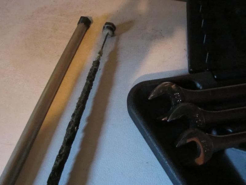

My annual maintenance is to check the anode rod and drain the sediment. A few minutes a year saves on some expensive replacement work. I actually just did my maintenance this week. Here is the picture of the new anode rod (left) and the one it is replacing (right). That is about seven or eight years on the anode and the second one I've put into the water heater. Depending on your water quality, I know people who have to replace their anode as often as every two years and some who get ten years out of them. Best to check them every year to keep the threads free, though. If you let it sit for more than a few years, chances are you'll never be able to get it out of the water heater without damaging something.

I just looked up the function of the anode rod. The Anode rod is a sacrificial piece of metal rod that is there to react chemically with whatever type of water(like hard water) is supplying the heater.
If the anode rod is deteriorated or gone altogether, the inside metal lining of the water heater would start to rust up and you'd have all sorts of problems.
I'll check my water heaters anode rod soon.

The anode isn't going to affect water temperature at all, but - as you found - maintaining it does give the water heater a much longer life than if you ignore it. I've had a number of people tell me a water heater doesn't last longer than four to eight years anyway, so why do maintenance? Well, an anode lasts about four to eight years and if you don't replace it then the tank is next and then - no - your water heater isn't going to last much longer than that. Sort of like saying a car will only last 40K to 60K miles, so why bother changing the oil or doing any service? Actually had someone tell me that... Well, if you don't maintain the car, it is sort of a self-fulfilling prophecy... :D

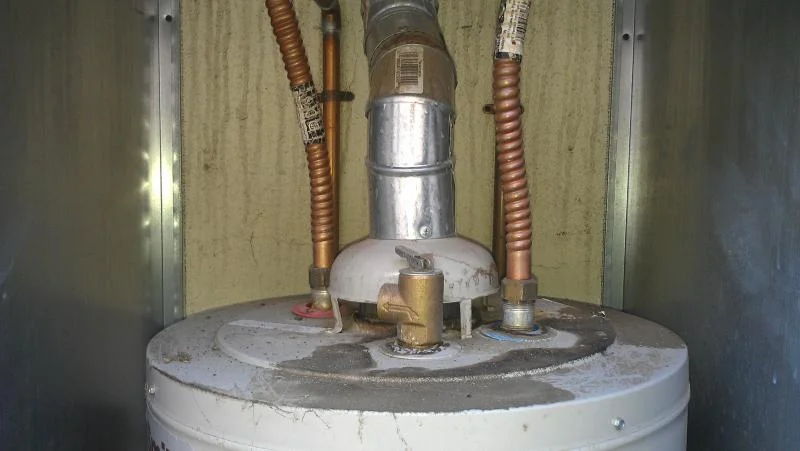

I took some pics of the connection on the top and correct me if I'm wrong, but isn't that valve on the top supposed to be on the side where it's labeled Relief Valve?
The port on the side(not pictured) labeled Relief Valve, is plugged shut.
Maybe I'm wrong....:confused:
No, the T&P valve can go in either of those ports. Technically, it should be plumbed outside, or at least to within 6 inches of the ground. That won't affect performance in any way though.
But I can move it to the side port, right?
