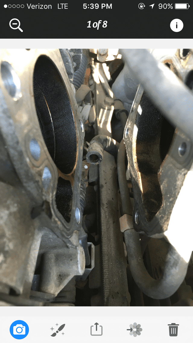

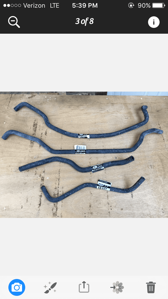

So, this pesky little critter lives behind and underneath the throttle body. Would like to replace while I'm in there, but do not know the shape of the entire house. I don't want to pull it off without making sure I have a replacement ready. Do any of these gates hoses look like the ticket? Or does anyone have a photo of the proper hose?
View attachment 1747538 View attachment 1747539
It's the bottom one in the picture.

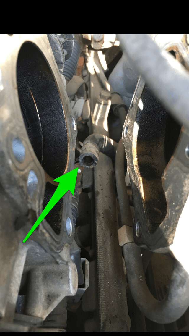

Do the red arrows point to the two throttle body coolant hoses?
Neither P/N gets me any useful information...
Thanks!

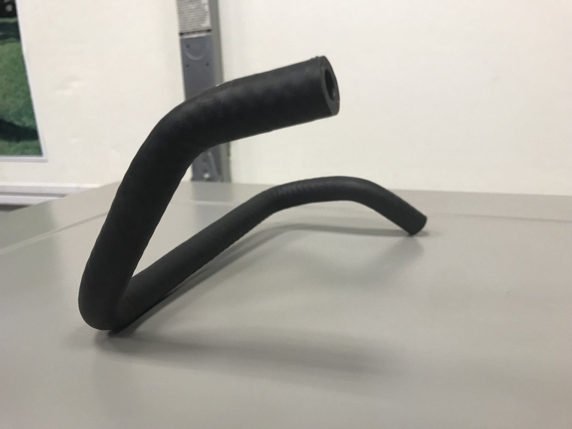

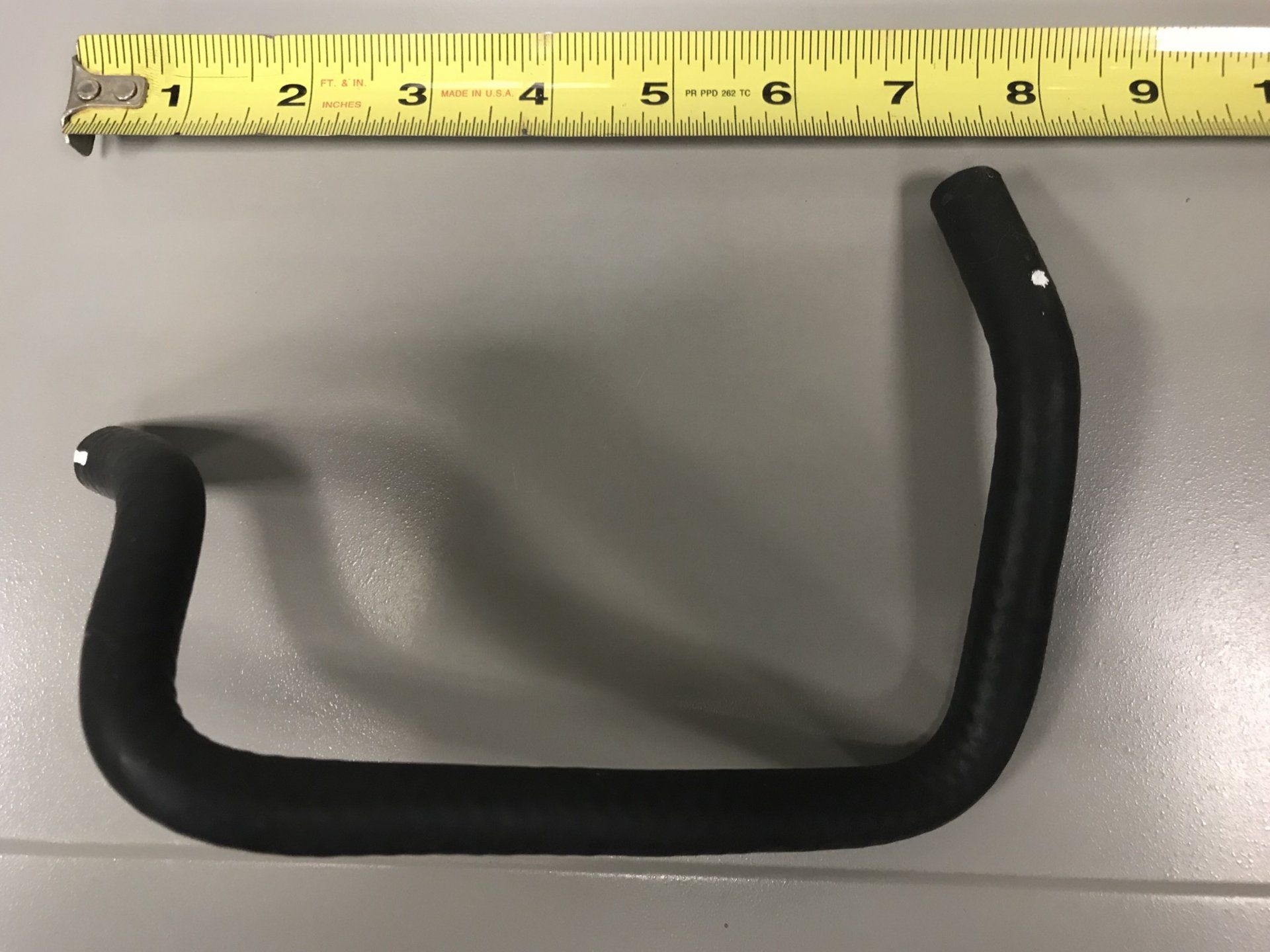

This is 16261G in your diagram (bypass hose # 1).
IIRC (it’s been 2 yrs since I’ve had mine apart) the hose end you point the green arrow to is the left side end in my first pic (with the tape measure). Mine is a ‘97 but I think the ‘95 is the same.
Great, thank you. This oughtta be fun.
Btw, the full dealer P/N on this puppy is 16261-66040.
Shorter hose off other side of throttle body is 16264-66021.
