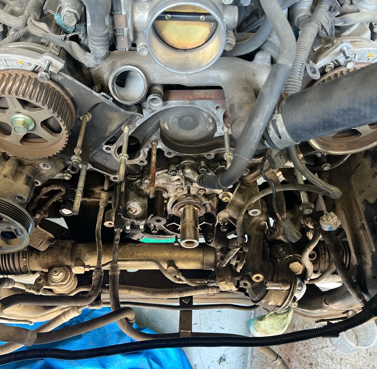

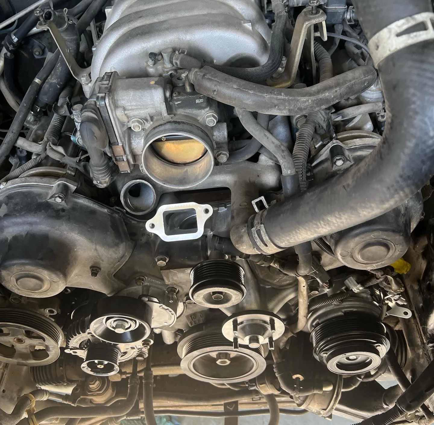

2uz has a few more pieces to deal with on the front face. I must admit I like the chain driven variants of the Toyota engines. The timing belt is solid in the 2UZ but needs to be replaced. The 1fzfe is simpler to work on and has a timing chain.
