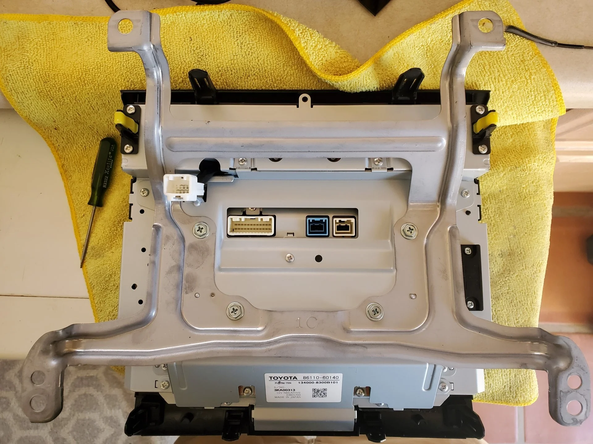

I'd pretty much gotten used to the quirks related to the head unit and had worked around them, what prompted this is that the hazards don't work and I wanted to test the switch. Found a video out of OZ that showed removal of the bezel around the display and switch in a 200. Seemed easy enough so I went for it. Got the side pieces, vents, top plate and shrouds off just fine, Really didn't even need to disconnect any harnesses or connectors. I quickly realized that the bezel was attached to the head unit by screws and tabs, totally unlike what was in the video. Further inspection showed that the display unit needed to be removed to really access the bezel. Four 10mm bolts, four connectors and it was out.
Then came the sinking feeling...It was apparent that the switch wasn't accessible without disassembly of the head unit.

It's underneath the sticker. I wasn't surprised at all to see this was manufactured by Fujitsu Ten. I've gotten parts from them a long time ago to fix a bad display in a Isuzu 'Pup. I'm thinking, it's just a bunch of screws, right?
A bunch of screws later and two ribbon cables later it was out.

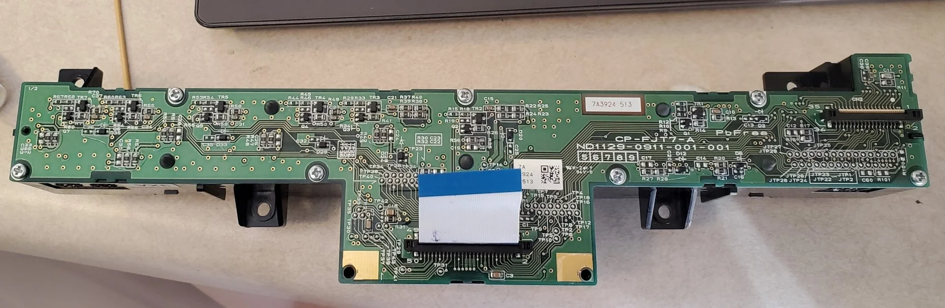

Wait! It gets better! The switch is integral to the entire switch assembly. it's soldered to the PCB on the other side of the ribbon cable blocking the view. Damnit!
At this point I'm, wow, what a crappy design to integrate that switch to the head unit. What were they thinking?
Just for S###s and Giggles I looked up the part number. 86110-60140. First hit from Toyota was a cool $4700. Olathe and the others had it in the $2400-2700 range. I wasn't impressed.

Then I noticed that the ribbon cable and connector had the blue corrosion, just you see from a leaked alkaline battery, just a little bit but it was there. I pulled the ribbon, used a little vinegar, sprayed the connector with plastic safe contact cleaner and cleaned the pins on the cable with a toothpick. I then cleaned the pins of the ribbon with a little Flitz metal polish and rinsed it all off with alcohol.
I was hoping maybe that was the problem, just a bad signal path from the hazard switch.

Today I disassembled the head unit again, clear down to the bare switch pcb. Inspecting the board I was able to test the switch with a multimeter. At first it didn't appear to be working but after an alcohol bath and some contact cleaner I was able to verify that the switch was closing contact and toggled correctly. Traced the circuit through the board and ribbon cable to a driver board that's heatsunk. Nothing looks out of the ordinary but I couldn't trace any further without desoldering two transistors to remove the heatsink. Plugged it all back together but still no hazards. @grinchy I'm going to talk to Phoenix tomorrow to see if they have a head unit that is compatible.
