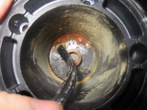

I bought the $100 part and rebuilt the gear side fairly easily while leaving the electric motor side still attached. It was surprisingly simple job. So I while I was putting the cable back on, I decided to check the cooling fan, which has only ever come on once during all my winching episodes. Nothing happened, so I poked the fan and it was frozen. So I pulled it apart to find this:
Anyways, water clearly got into the fan while mounted under the hood, against the fender behind the air intake. There really aren't any holes into the motor compartment, but it somehow it managed to fill up and corrode it badly. I did manage to loosen it up with machine oil and get it working again after popping off the top with the brushes. Now something is not giving it power out of the solenoid box, so I'll have to dig into that now to see what is either fried or broken. Even without the fan, the winch still works just fine for short pulls.
I think the main part is sealed fairly well and without the fan it is still a good winch. The fan is really a gimmick for reliability until they figure out how to seal it up, although, if it runs it will do its job cooling. If you have an endurance, I'd make sure to keep the fan intake pointed down to drain and run it every so often. My intake was at a 45 degree angle up, now it's down. I wouldn't push the winch very hard until you check the fan with the controller switch, just in case yours is rusted up. My other big concern is water draining down the hose and into the winch itself.
