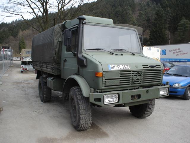

I remeber when I drove a UNIMOG 435 with 6L 3.0 engine nat aspirated .. to move a 4 ton truck ? ( I'm not sure if it's rated 4 ton but is huge ) the issue is it have 8 speeds .. and when it was empty you can start in 3 or 4 speed and shift to 6 at fast ..
Top speed 80km/h ..
Top speed 80km/h ..
Did it have the portal axles where you can swap the upper and low drive gears in the hub?
Its such a cool set up:D
There will be lots of mogs for sale in oz soon The army is switching to another 4wd truck,Hino Ranger 4x4:grinpimp:.
So there will be 2000 mogs unwanted:grinpimp:
I'm a MOG lover .. are awesome toys .. and yes are Toys .. are not long travel rig IMOP .. and you need to spend a lot's of $$$ if you want make it compfortable ..
I thought expensive and heavyest rig .. ( out of this size ) but definately awesome mahines ..
