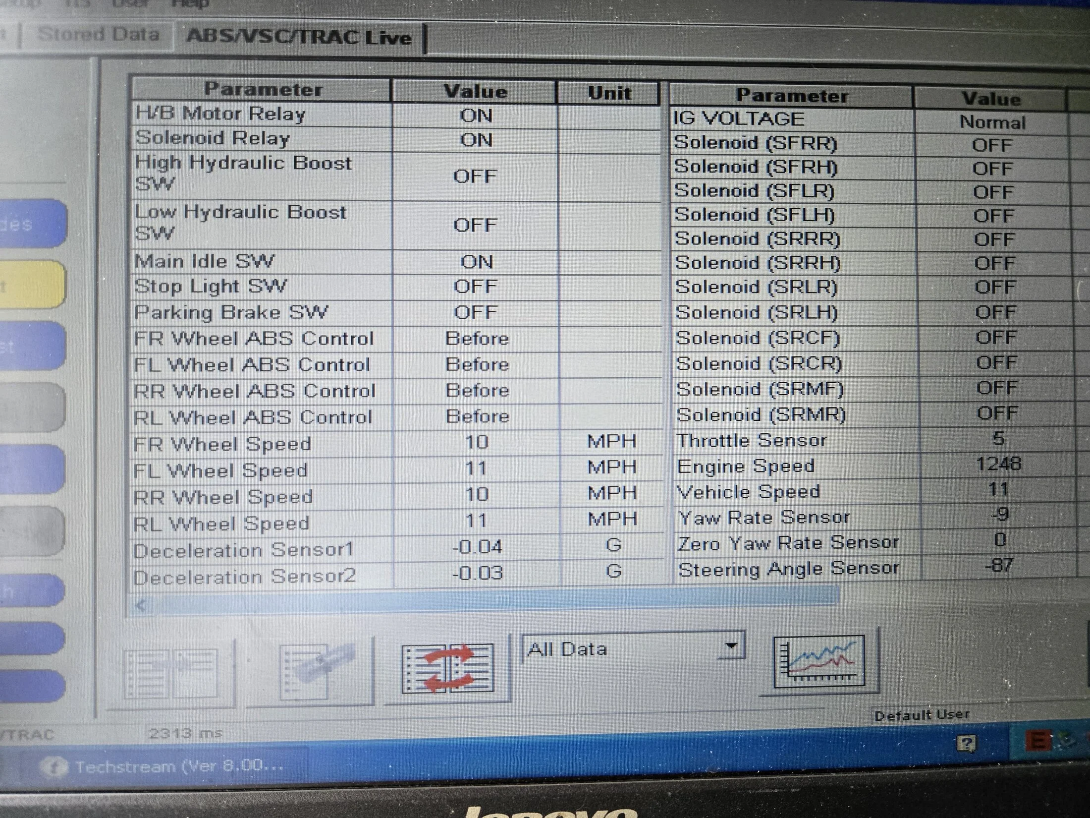

Once the light comes on, I believe a proper scanner or tech stream can tell you which one it is.
If they're not all the same, does this imply uneven tire wear? Assuming a zero would be a failed sensor, correct?

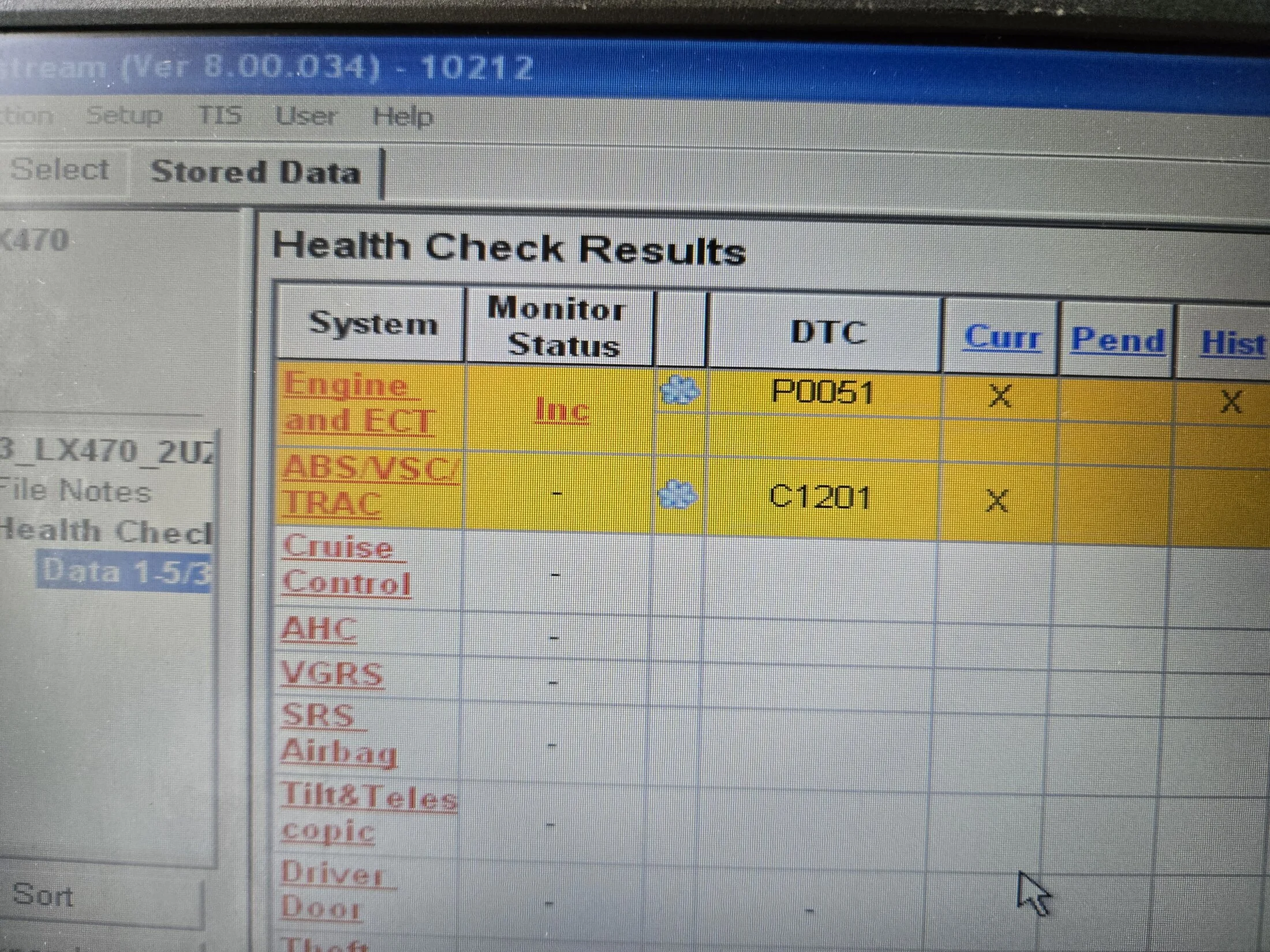

Mine's a 2003, North America model. I ran across a general Toyota video suggesting there is a general behavior from Toyota ECM to display the VSC and VSC TRAC lights. I happen to also have a p0051 code(upstream O2 sensor, bank 2). I will post back in a few days once I get time to install the new 02 sensor see if the guidance on the below YouTube video link proves true. The gist in the video is basically that the other stored codes besides the c1201 code are the true root cause of the generic c1201 dtc.

Update after new o2 sensor and 300 miles, no new DTC's. I think for the future when people get these lights you've got to check/resolve all your dtc codes first -the failsafe mode(and accompanied trac lights), C1201 dtc as described in the fsm can be triggered by dozens of other codes. Strange to lose traction control due to so many unrelated DTC's.
