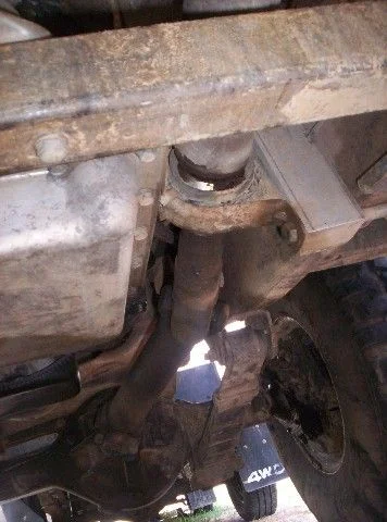

    Rear is centered and the front output can be had with passenger side drop for a Chevy(88-91) Blazers and Suburbans. The Dodge 241 can be had with the passenger side drop also just not sure what years. I would use the Dodge 241 with a Chevy input gear (Oranges idea) so that you can do away with the rear slip yoke. I'm running a 700R4 with this setup in my Pig and haven't had any complaints. The only problem I had was having to run a 2 piece front drive shaft with a carrier bearing in the middle to get around the tranny pan.
    :beer: :flamingo:
