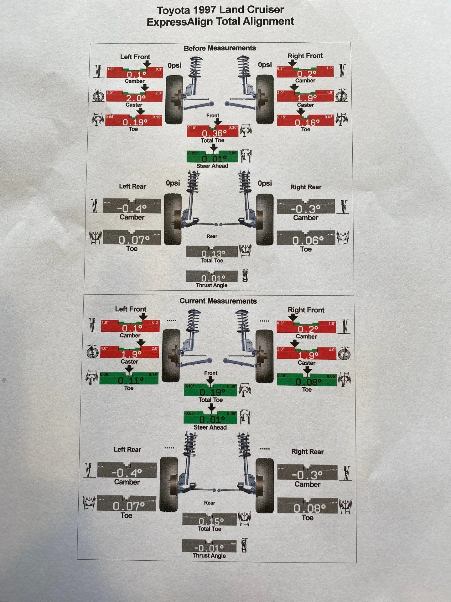

Here is the before and after alignment. Done a month ago after new tires, and before lift.
