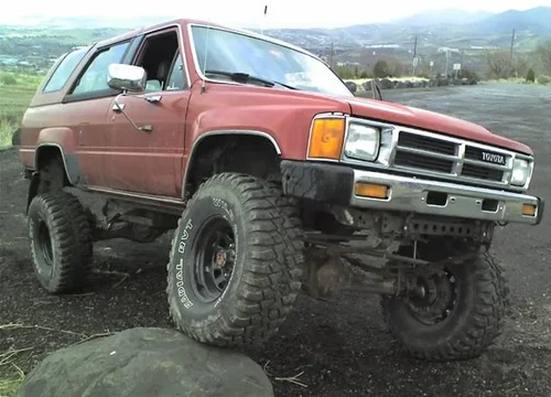

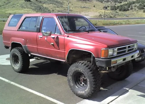

For context, my current rig is this little puppy:
1987 4Runner body and drivetrain on '85 Frame. Upgraded brake system: '87 rear axle (bigger drum brakes), new '82 FJ40 vented disks, rebuilt '92 IFS calipers, V6 master cylinder and brake booster. Chevy rear springs, Allpro 3" front springs, Bilstien 5150 shocks in front (12" travel) and rear (14" travel). Taco e-locker in the rear, high pinion FJ80 e-locker in front. Drivelines both have Toy CV joints, done by Jesse at High Angle Driveline. Marlin crawler crossover steering system using super beefy frame gussets. Rebuilt front and rear axles. New oem oil pump and cam from www.engnbldr.com
I will be putting on the Marlin Crawler rock sliders I have in the garage, and welding together a swing out tire carrier bumper. Then it's going to be sold. Having only two doors, and a (relatively) harsh rides are becoming turn-offs as I age.
Right now the vehicle gets me 19mpg on the freeway (70-75 mph). Not too bad considering what it can do.
The rig you have is a much better base for a tricked out offroad rig than an 80, and I can't imagine you are getting great gas mileage, so what's the problem?
The only reason I can hear for doing an 80 is you love them, so what possibly can be a viable alternative? I can list you a bunch of rigs that are a better base than an 80 for a major project, but what does that matter since you already own one of them?
