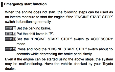

You may also want to try the Emergency Start Procedure (page 638 of the Owner's Manual for my 2013LC):
HTH
The first or second thing I did (see original post) was changed both of our key fob batteries. I am aware of the key fob hack to put it close to or on the starter button, I do believe this worked unsuccessfully during one of the failed start attempts.
Did you try the Emergency Start Function I posted above?

Great idea. I interpret the emergency starter function as a tool to rule in the fact that it the problem is isolated to the immobilized system. At this time the vehicle is starting, I will try the emergency start immediately the next time it does not start. The trouble with this whole situation is that I have to wait and see until the issue presents itself again. I had the vehicle at my mechanic for 2 weeks and they could not replicate the proble,
