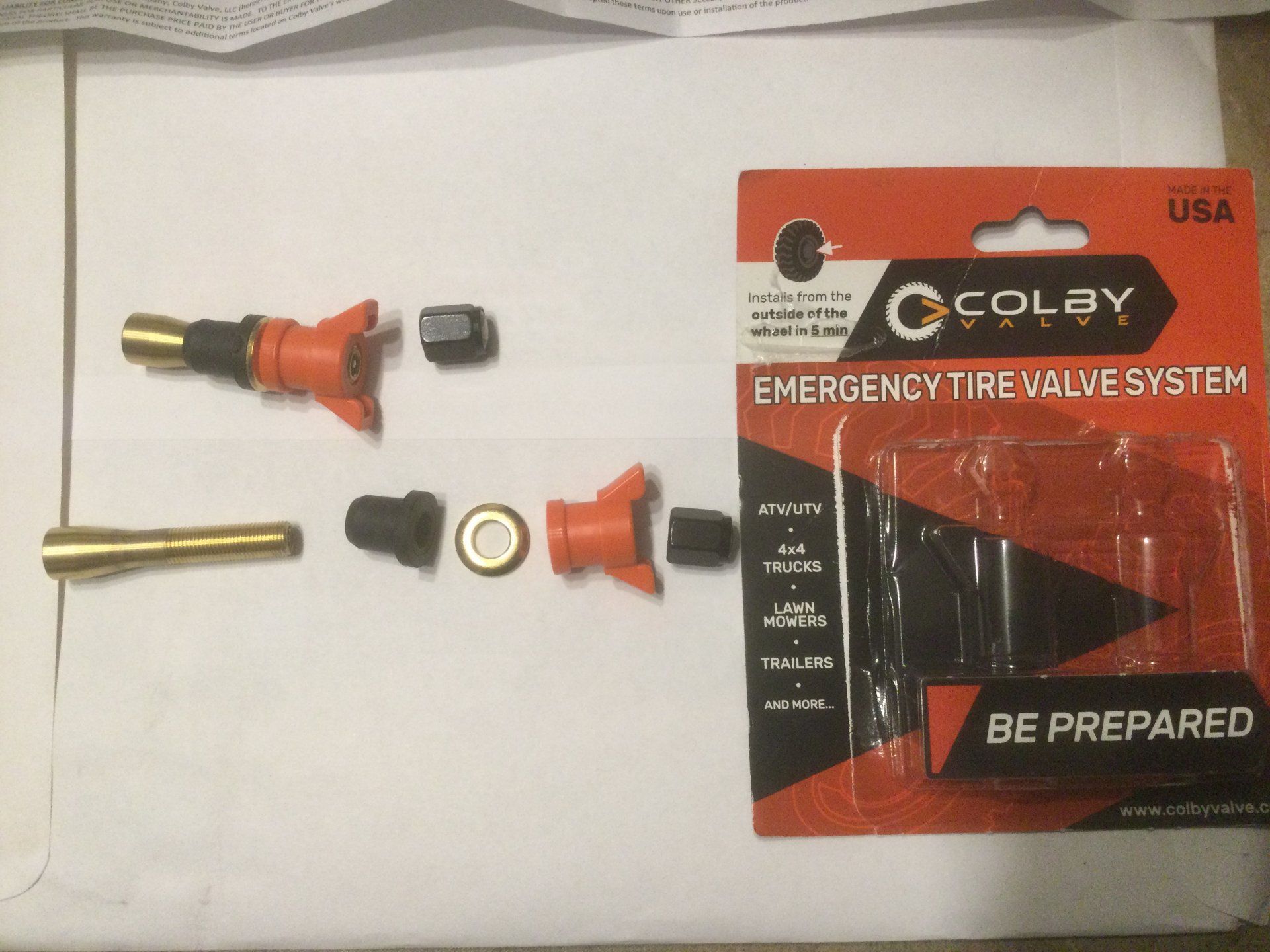

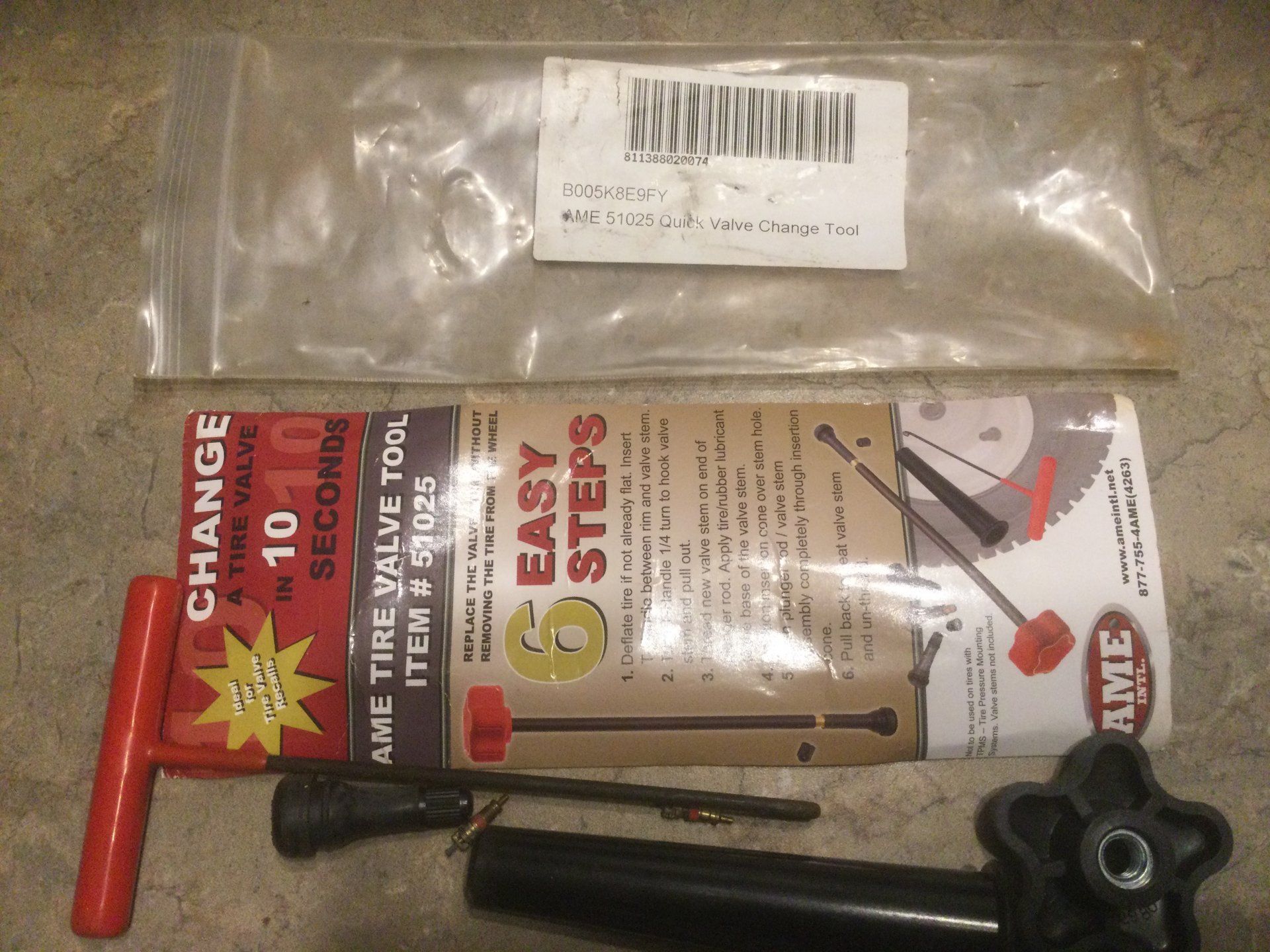

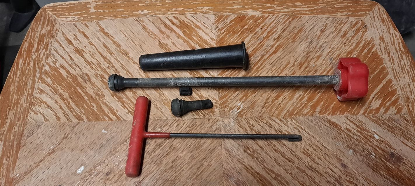

This kit is available locally at Extreme Dreams in Abbotsford, you can replace a broken valve stem without removing the wheel. Be handy to add to the tire repair portion of ones essential tools.

I wonder what the cost is? There is also these an an option. Says they are safe to leave in the wheel permanently. I originally thought they would be crazy expensive but there only $40 bucks a pair on amazon.

I’ve got one of those. It works really well. Wasn’t that expensive. One of those good to have
in the bush tools, like a really good plug and patch kit.

Thats the thread on FB where I saw the other the ones I posted (They are about the same price). There was a tire expert (Ken Noakes) saying the tool kit is a better option than those Colby units. Reality wise, I think I've only ever had to repair one valve stem over the years, and that was purely because it was a metal one not rubber.
Just reading up in those Colby Valves. That looks like a really solid option.
I wonder if you can re use them? Remove it after emergency installation and then put
it back in the tool kit for next time?
Hi ! To answer the question ... yes, they are reusable as long as the gasket isn’t damaged/torn. There is a short how to install/uninstall vid on our site. We should have the gaskets available soon in packs of 4 . Basically your parts that can more easily wear/be damaged would be the gasket, and the schrader valve core(always make sure to put your valve cap back on 😃)
