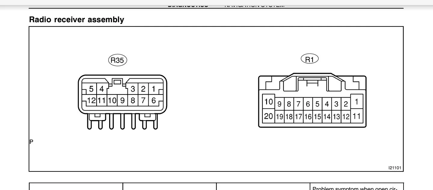

Don't know, but some clues:
They have different part numbers:
2001 LX470 86111-60031
2001 LC 86111-60041
I happen to have a TIS subscription going right now but I've poked around a but on your year and it is not clear how to be certain.
The wiring diagrams are different, however, and it looks like the harnesses are different if I am reading the diagrams correctly.

Wow, this is super helpful, thank you! Exactly what I needed and couldn't find. Based on the schematic you shared for the toyota pin outs I think it will actually work. Here's the connector they're showing for the 2001

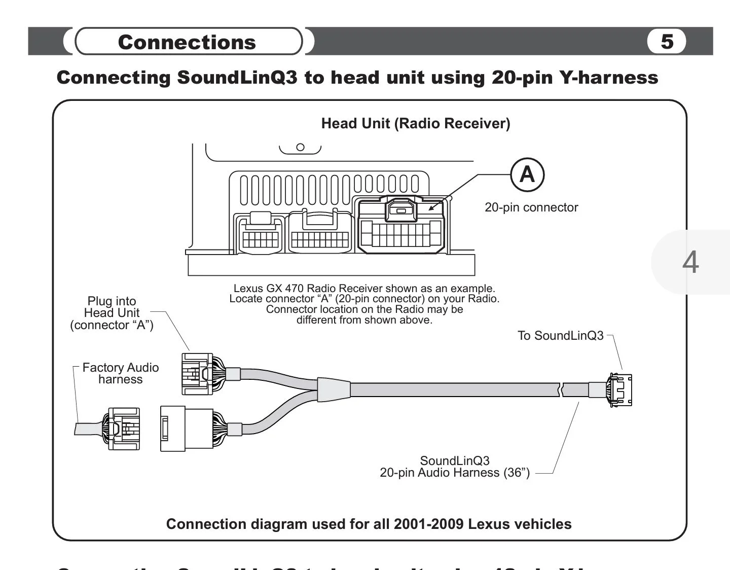

And here's what the VAIS directions show for the Lexus
That 20 pin connector that I'm supposed to use sure looks the same to me. I'll go ahead and take the dash apart and see...worst case it doesn't work and I just button it back up, but it looks to me like it's worth a shot. Thanks again!

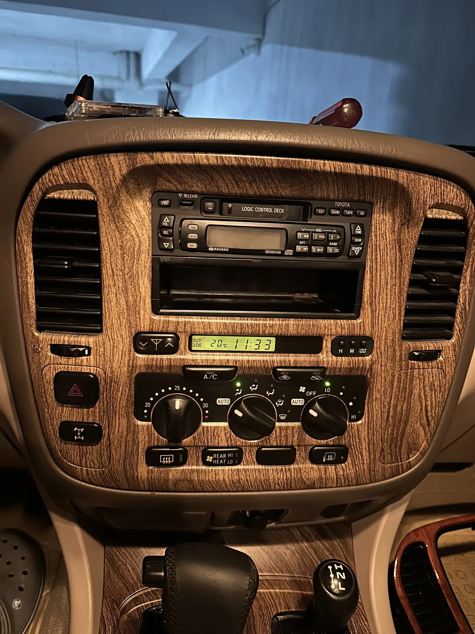

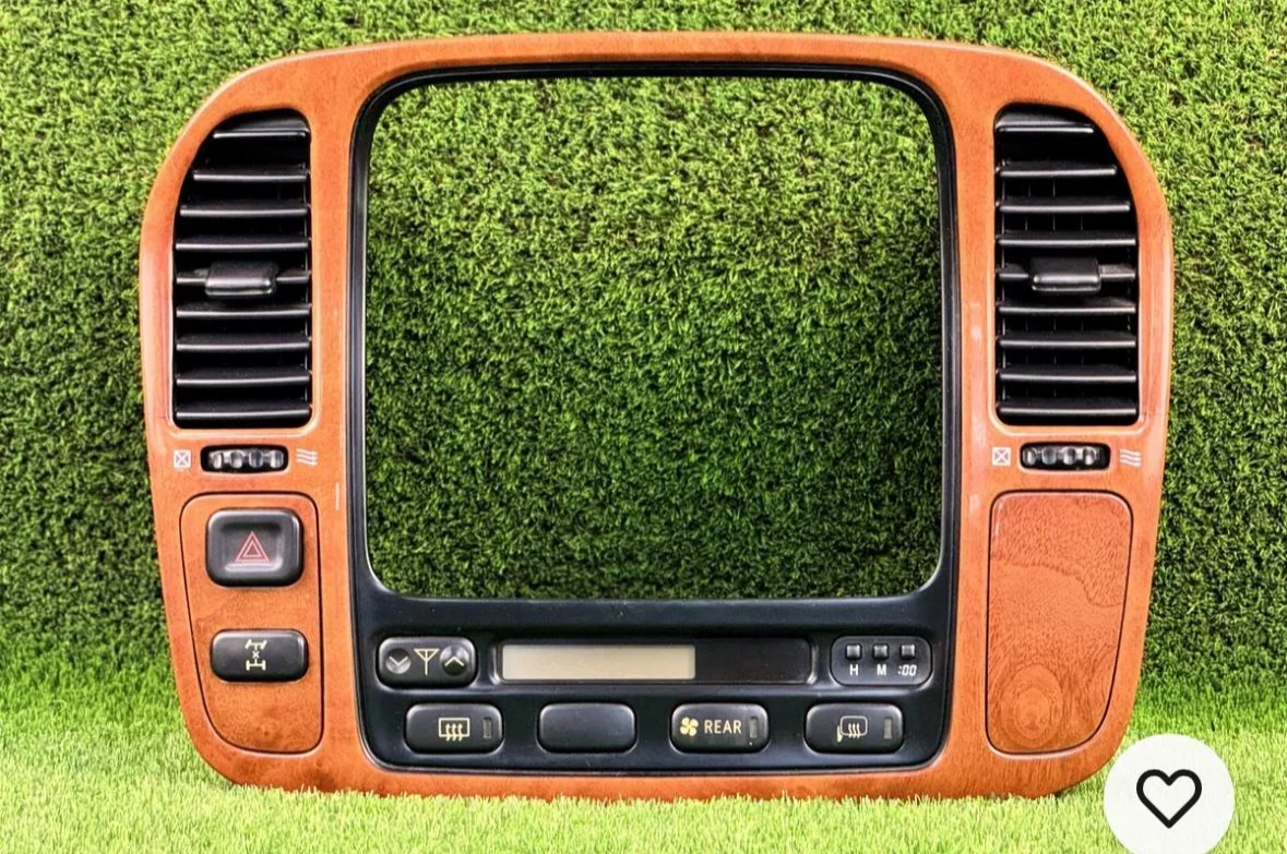

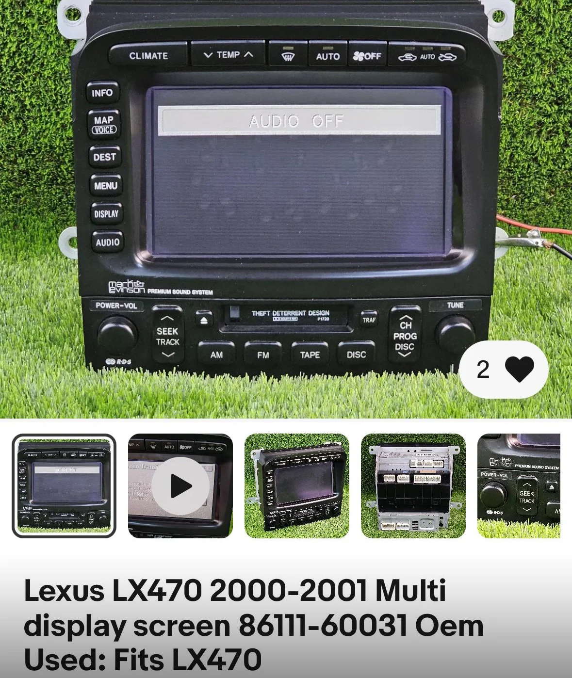

Hello every body
I have land cruiser 100 2000 years old. I will change radio and climate control unit. I bgouth nav. System(86111-60031) and basel(84010-60220)
I checked all forums but every body remove reverse operation😊
Can you help me please.
