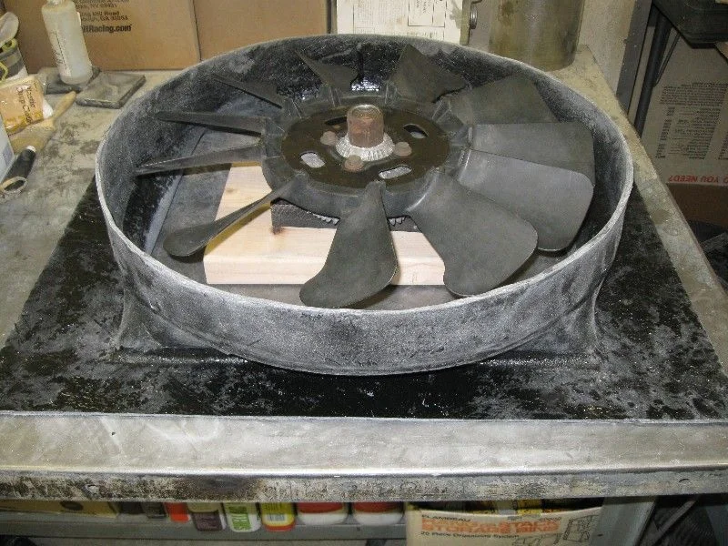

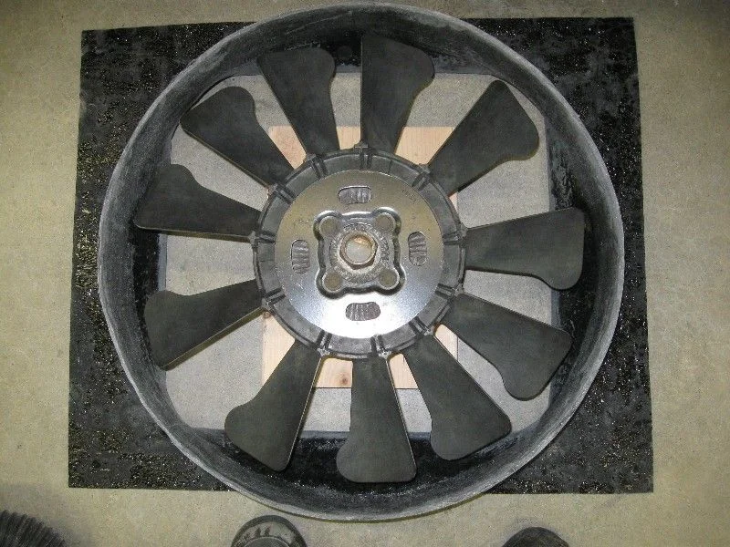

It's just a stock Chevy/GMC fan and clutch from a larger late model truck/van (Suburban, Yukon, Savana, Sierra, etc) that directly replaced the original fan on my engine. I don't recall whether I got it at a junk yard or from Ebay, but it wasn't expensive and it moves a lot more air than the original fan. I built a fiberglass shroud to mate it to the 19x22 (IIRC) aluminum rad. The fan is 19-20 inches in diameter.
Not to Hijack but I'd like to see/hear more about that fan:
