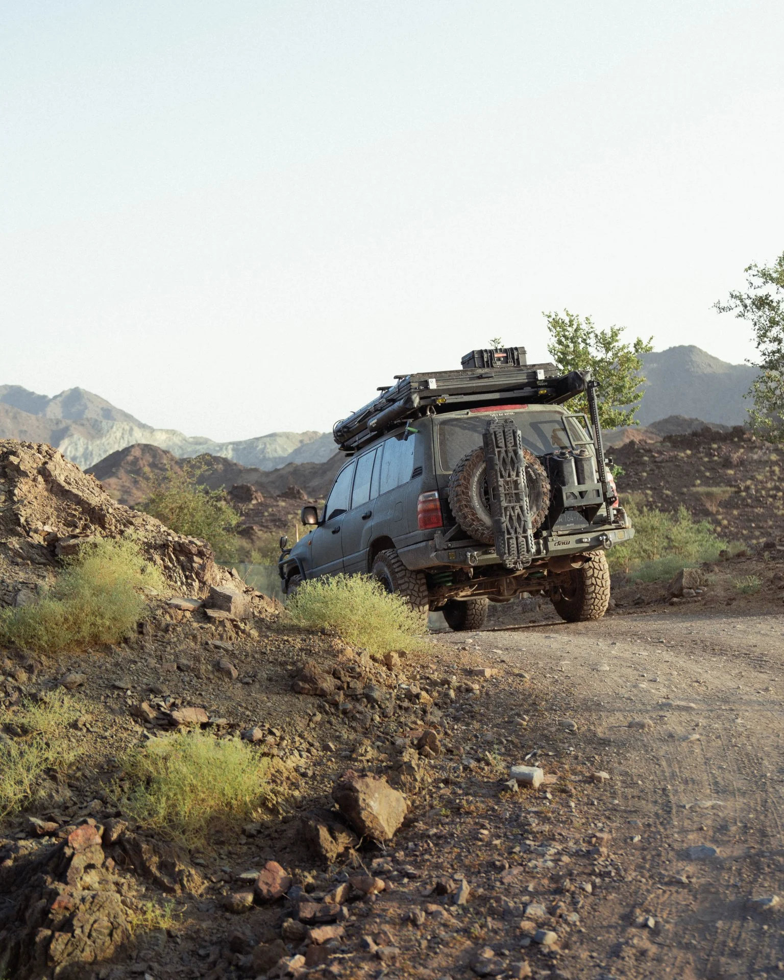

My HDJ100 broke down in Oman. My wife and I have been traveling overland around the world the past 5 years.
HDJ100 from 1998 4.7 Petrol 350 000kms
