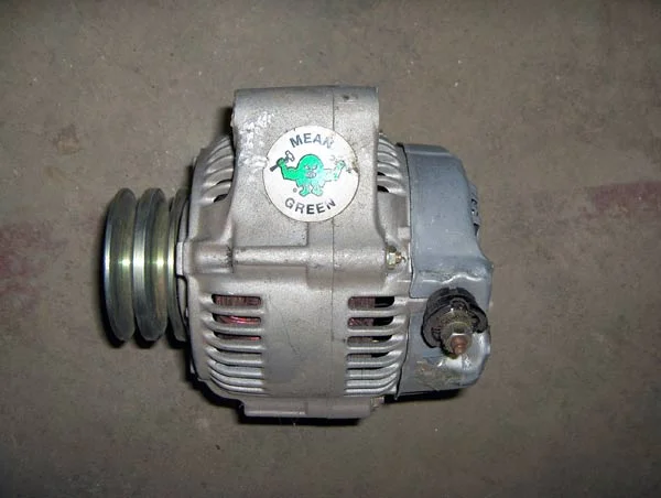

I got a Mean Green alternator (see pic) from their store locally and had it tested. The alternator shop did a carbon pile load test or something like that and it put out 78 amps. This was maybe four years ago. Maybe something has changed now or maybe they have two lines, but I asked for the hi amp alternator and this is what I got. The alternator shop did tell me that many outfits ramp up small case alternators, then shorten the warranty’s as they tend to run real hot and go bad. They said to get a true long lasting hi amp alternator it takes one with a larger case. These will not fit as far as I can tell in the stock location. Again, this was around four years ago and I am no expert so don’t know for sure. There are many companies that make hi amp alternators and I am not looking to dispute any claims; just stating what was said to me. Anyway, in the second pic is a 100 amp Delco that I adapted on to the stock location. I made the spacer this size and painted it this color reasoning that if I had to change it out in the backcountry and dropped the spacer I could easily find it. The adjustment bracket was a little tough figuring the radius using the same stock type of adjustment bolt. Wiring adapter was figured out by the alternator shop I have dealt with for years. Stock is supposed to be 80 amps so this is a little more but I understand these particular Delco’s may not be too good, so I bought a spare.

The black pulley that is on the Delco in the pic is the stock pulley from the Toyota alternator. The shafts are the same so was just a switchover IIRC. Maybe a washer adjustment? Can't remember. So the Delco will turn the same as the stock alternator. I very quickly measured the outside of the Mean Green pulley, which is not going to mean much, and it was just slightly bigger than stock. The Delco came with a ribbed pulley.
