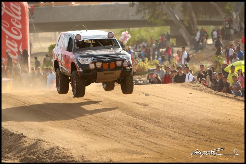

Monica runs stock LCAs fyi
They claim they are "stock" 😉
My Tundra stock arms have been holding up well even using King bumps.
Agreed with others. When the stock arms are up to Baja 1000 duty, with 37s, that's pretty much the definition of strength and hard to need better. They're also getting huge travel so the OEM joints aren't necessarily a limitation.
Canguro seems to have swapped over to Tundra arms more recently. Older pics show tires flush with the body, versus newer pics showing some poke. We'll see if they equally hold up. There's been some rumblings that the 200-series arms use larger hardware and bolts to the Tundra arms. I've heard as high as 15" travel quoted and it's not obvious if this is on the 200-series length arms, or the longer Tundra arms.
