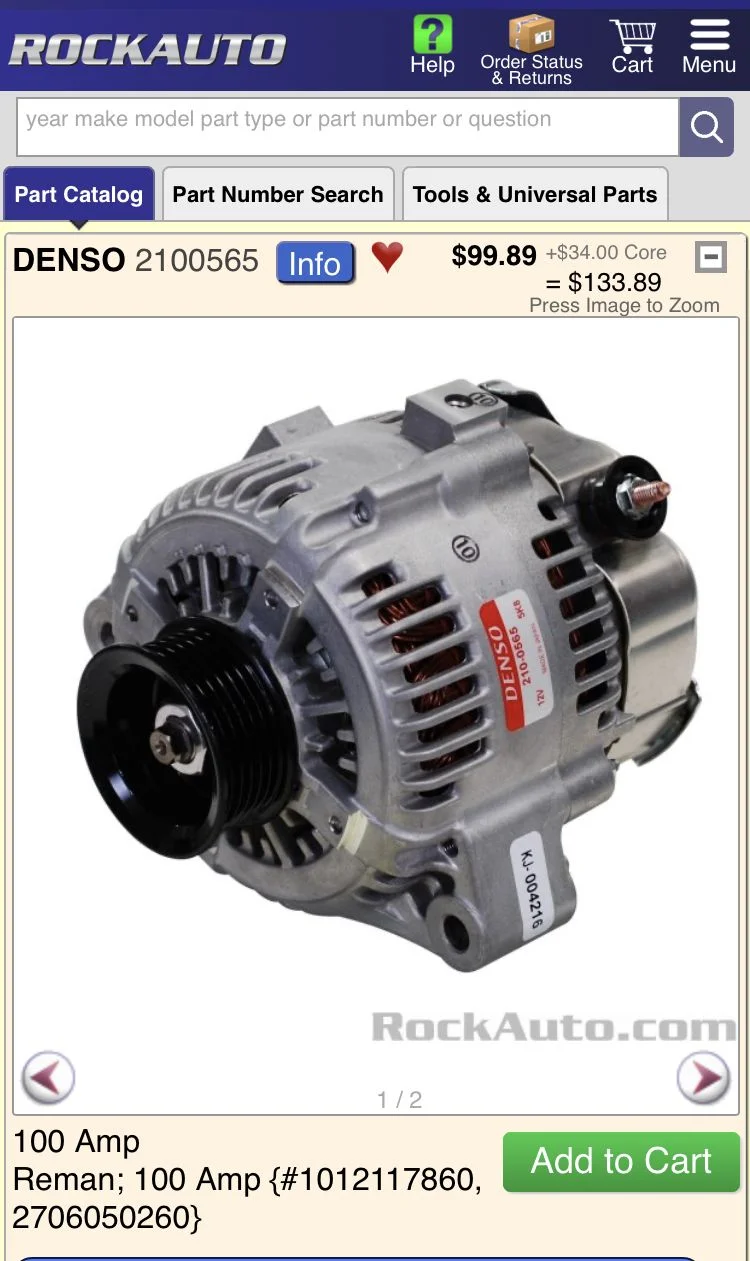

Having it tested is a good idea. Pretty quick for any chain parts store to test battery + alternator.
Regarding whether to rebuild or replace, that really depends on your situation. If this is your daily driver and you don’t have another vehicle, then you need to buy another alternator to minimize downtime. If the cruiser can sit for a few days, then you can rebuild your alternator or have a reputable shop rebuild it for you.
FYI, you can buy a rebuilt Denso (OEM manufacturer for Toyota) for $134 + shipping, which, after you send back yours as a core, totals $100.
