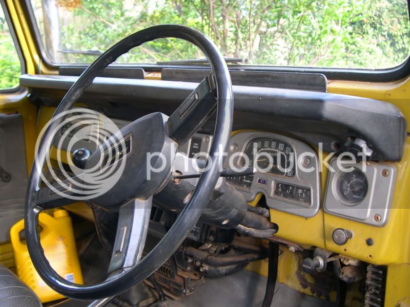

I took delivery of an '81 HJ47 this weekend and have no clue what the purpose is for the translucent green knob to the left of the instrument panel. Could someone please have a look and tell me what it's for? Is it the glow-plug indicator?
Thanks,
Steve
It's not the glow plug indicator... That is the screen below the light switch on your right side.
My guess is that its a sedimenter warning light... or it could be a replacement front drive knob... does your transfer shift knob have a H4 setting? or just L and H?

thanks--btw, the glow plug indicator doesn't glow (but i'm pretty sure the gp's are working)... what is it that's lighting up back there that needs replacing?
there's a light labeled "filter" next to the hand throttle--is that for the sedimenter?
oh, and the transfer case has an H4 setting
-steve
Based on my experience with BJ series diesels, it's the sedimenter float warning light. It should come on when iginition is on and engine is not started. If it stays on, the sedimenter is full of water and should be drained, or (IIRC) it could also mean there is something amiss with the alternator (worn brushes usually).

pull it and see what happens, the only green knobs i have come across is for shutting all the power off for extended storage to prevent battery drain...
if there is a loud click when pulled then there you go... otherwise take a pic directly on the knob...
it pulls to a detent, no loud click, but there are a couple of wires coming off the back that dissappear behind the instrument panel. it looks to me like it has a broken lightbulb in it (the knob comes all the way off if pulled beyond it's travel)
here's a pic from straight on...
-steve
Doesnt even look Toyota to me. Its probably something it has accumated in its 25 year life span.
My guess is that it once ran some extra lighting;)

the filter light is to the right of the hand throttle--it comes on with the key and then goes off when started.
there's a screened hole beneath the headlight switch--i understand that's where the glow plug indicator is (but it doesn't ever glow)
the knob doesn't turn/twist, it just pulls out with a click (not a relay kind of click--a knob kind of click) and if i pull more, it comes off and gives access to the lightbulb inside
If it was Toyota I feel that it would be on the same level as the other switches not out of alignment.
I meant to mention that also.
If thats an oz spec vehicle they usually have a about 20 auxillary switches added by successive owners,yours has one so it must be low owner vehicle:D
It was probably for some auxillary lights or some such.
