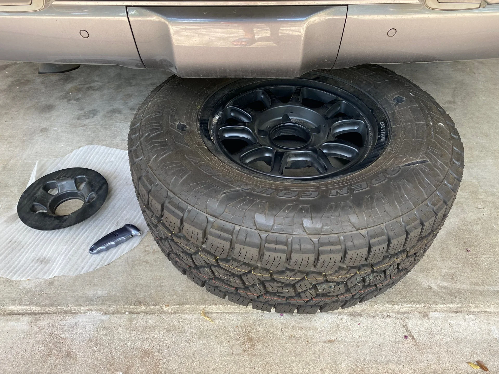

After being annoyed by my last spare getting marred underneath by crossmember pads etc i vowed to find an easy solution before remounting my new one.
Since i may rear carry the spare in the future, i wanted to make sure i didn't disfigure it this time.
It is $300 tire after all on a $400 wheel, and if i can do something about it i will.

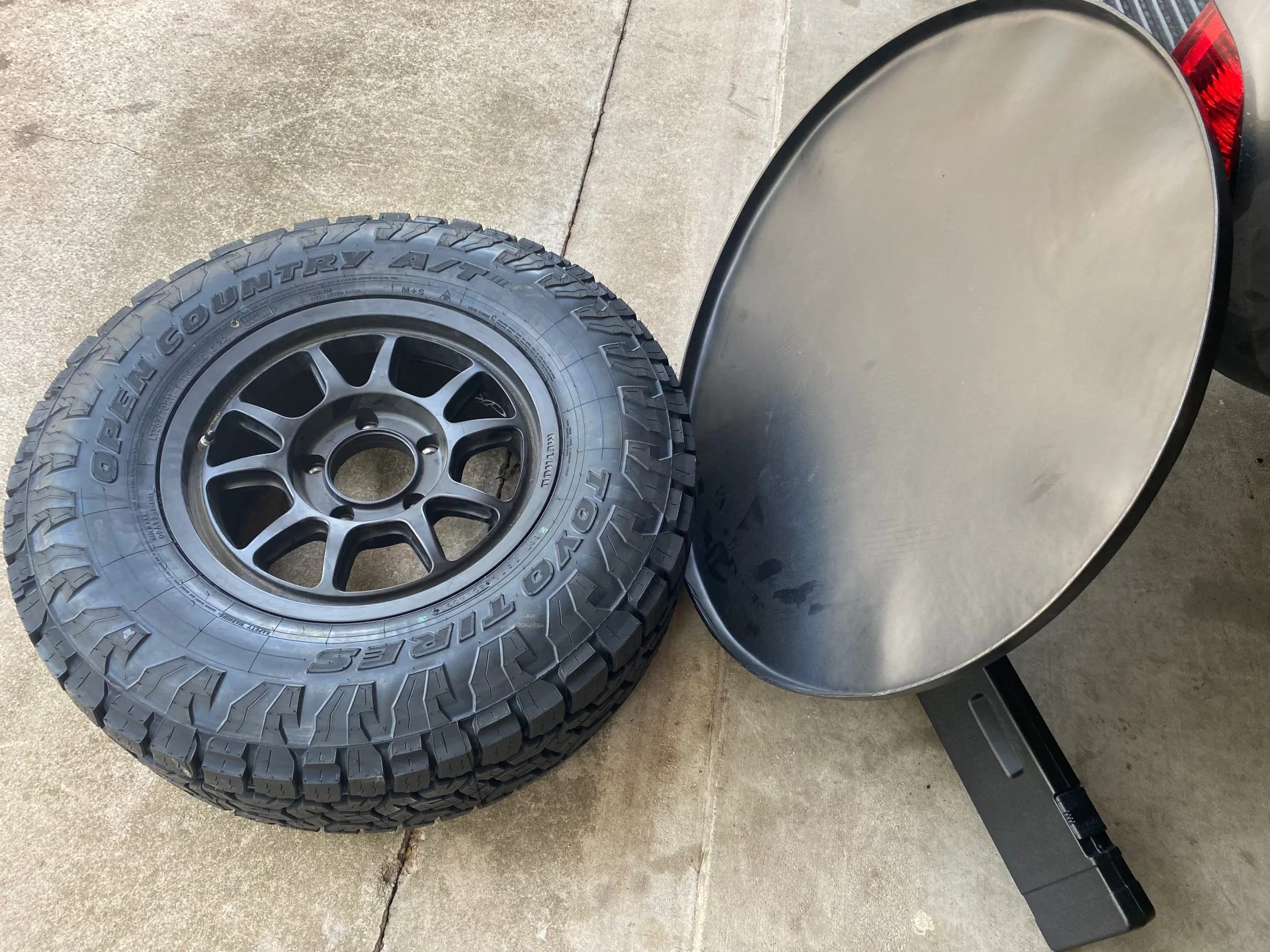

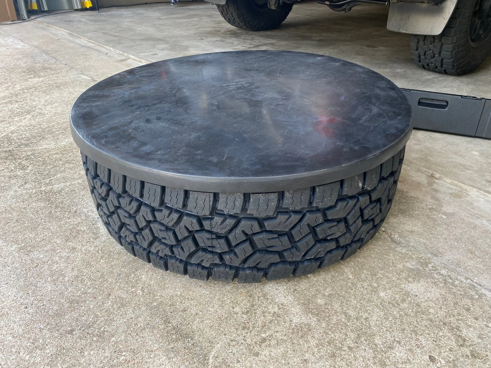

So if you are crazy like me, this is a quick and easy solution for just about any size tire you may want to stuff down there that would otherwise fit un-modded.
It fits like a glove against the rear underbody spare form and just needs to be slightly guided onto the bracket mounted in the front so it seats flat.
All i did was make a 4" hole in the center and up it went. It does not cause the spare to protrude any more than normal.
I liked this solution because it has a nice built in lip to prevent slipping around and happened to be the perfect size and is not super unreasonable in price.
I couldn't find anything like it and its not exactly cheap but if you didn't want the additional lip/edge you could obviously just use sheet plastic or whatever weather / heat resistant material you wanted. This took me 5 mins to put on but at least a week of searching.
Heres the link to the product in hopes of saving your time if you are interested. I worked with them on the shipping.
Cheers and happy OCD!

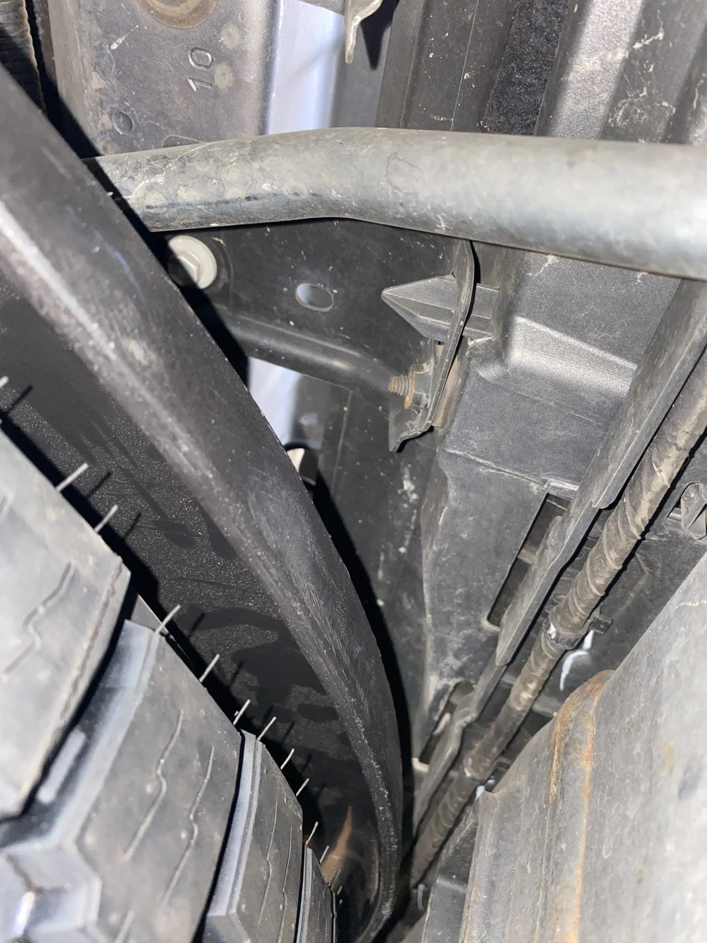

where was the contact point? I was worried about that too and I cut a hole in the middle of one of those gym interlocking mats and padded between the wheel and the frame but wasn't exactly sure if I had covered the point of concern. i did worry if my solution would collect water or mud and cause issues too...
There were multiple.
Theoretically, and i don't remember myself, those bumper pads (the round induced defects) should interface with the OEM wheel face.
With these fitments thats all rubber where it wouldn't otherwise be.
I believe after that its the support bar / brace? on the rear subframe towards bumper.
It crosses against rubber again but i think that was the case on OE package as well.
My memory of those is not all there though.
Stock set went off the truck fast and the spare wasn't new either so i didn't much pay attention before they all got sold.

Works great still. Spare unharmed
Great idea. Will try it. I just bought a lightly-used 2019 and when I dropped the spare, it was covered with fine sand. The four rubber crossmember pads had literally ground round divots into the wheel's face, through the powder coat and into the metal.

I bought a 2021 LC earlier this year, and when I lowered the spare a couple weeks ago to check it, it was (1) the original spare tire manufactured in 2020 and (2) severely gouged. The damage to the tire was similar to the photo you posted, but mine was in 3 or 4 different places.
I replaced the spare with a new BFG trail terrain to match my other 4 tires, and I plan to do a 5 tire rotation. I purchased the same protector thing that you did. Just finished cutting a 4” hole in the center and remounting the spare. Works perfect! A little pricey, but as you said, it’s protecting an expensive tire/wheel, and will do so for hopefully the next 1-2 decades in my case. So I’m happy with it.
