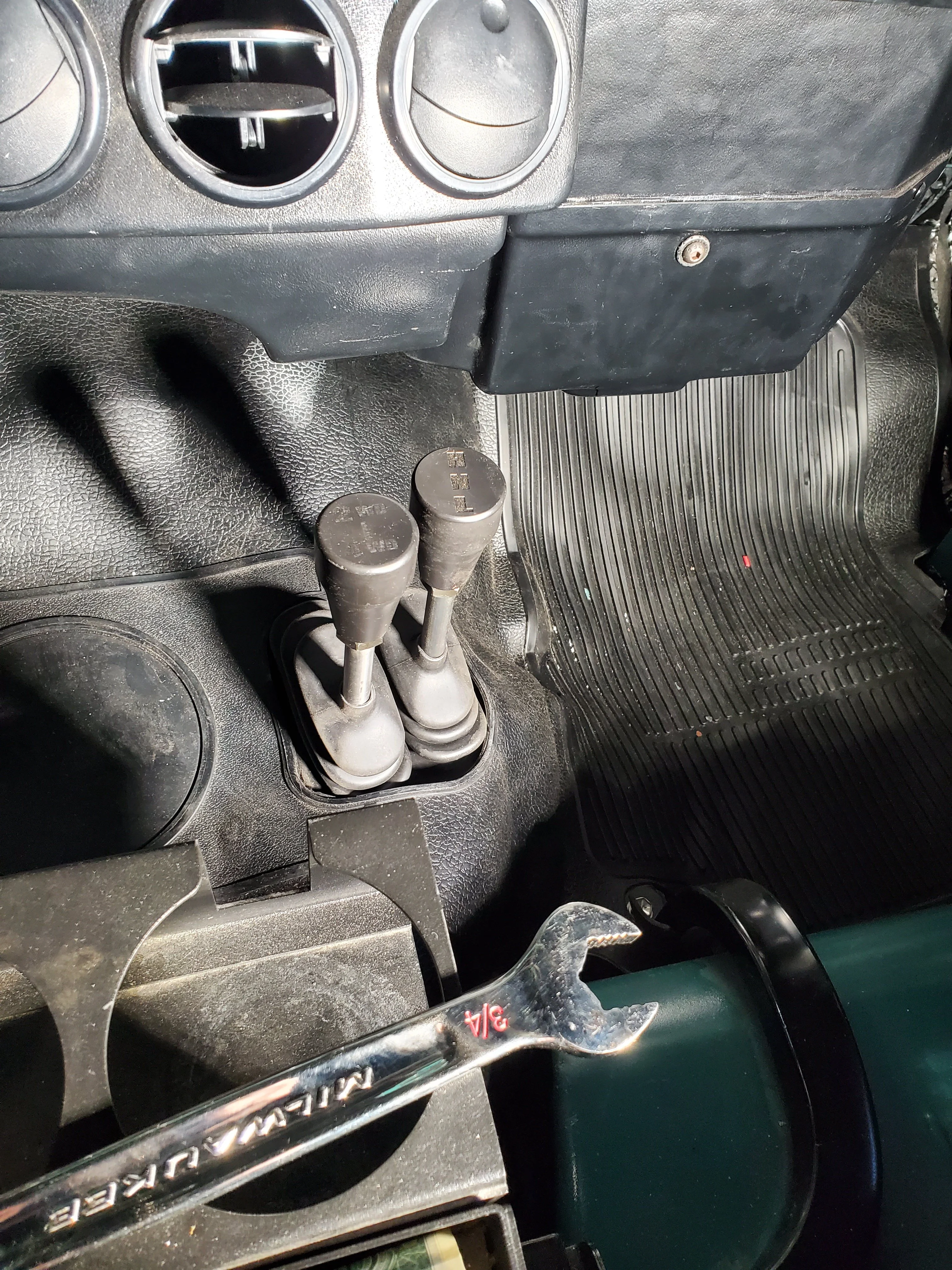

I feel like i know the answer, but I have the VA air conditioning installed with a new drier and I just removed the passenger seat to install a new fuel float and put it back together.
Do you think I can install the AA twin sticks without removing the transmission hump?
Wow I'm lazy
Pretty sure I did mine without tearing anything apart.
D

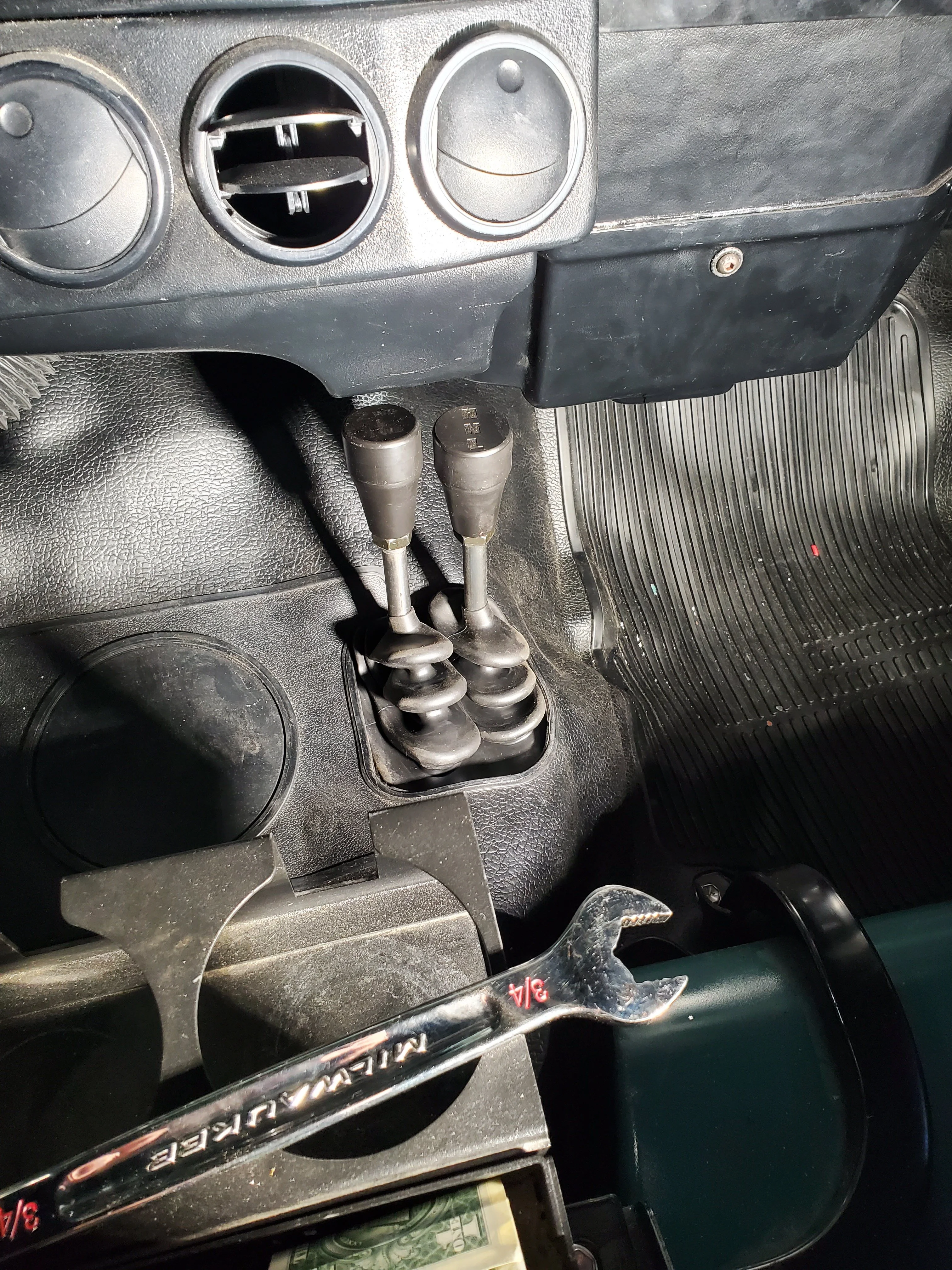

My AA twin sticks fit in the stock (12/79) tranny hump opening just fine; did not remove hump to install:
I am curious how does the high low lever work on 4/75+ cruisers where the lever points forward? Does the kit include a special lever to point it to the side. That would seem to be the hardest part to achieve with the cover in place. The 1/79+ only has an inspection cover. Doesn't allow as much excess but can be removed and only requires removing the floor mat to do it.
