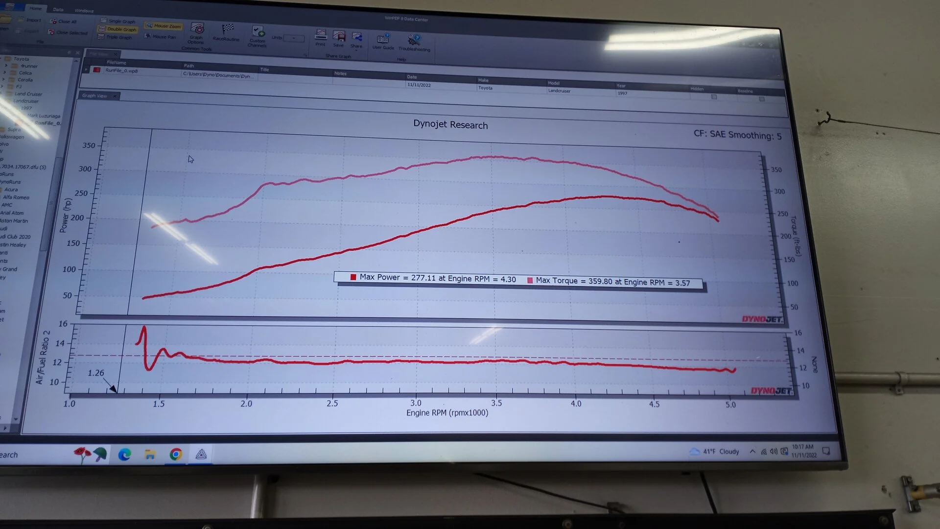

Not sure why all there's all this talk of boosted fz needing to be wound up to make power cause it sure isn't true.. compare this dyno chart to a dyno chart of any stock LS1/2/3 newer LT or choose your small block flavor and see what you think. Keep in mind you are going to be comparing my power zapping full time 4x4 dyno chart to rwd only charts. Torque comes in right at 2k rpm and you are going to find similar for those V8's. This is on a lower than stock compression as well, not the oem 9.0-1 on 10 psi of boost with premium fuel.
