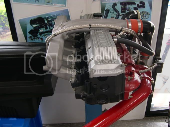

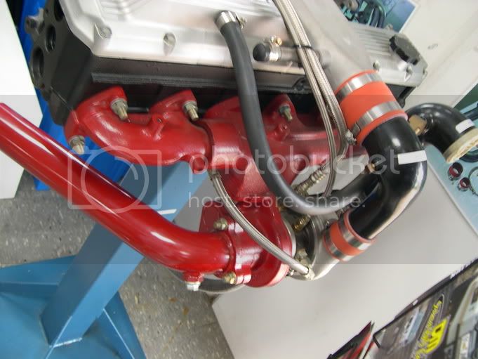

The safari has a better designed manifold, especially with the 2H.:cheers:

Wow, gotta hand too Safari, that is one complete kit.
I really like the intake cap with 90 and even better the intake pipe over the valve cover, looks so factory.
To me the safari looks more efficient and better designed than the rest. Even before anyone points out they are not running at 7.500+ RPM. Even the old 2H setup looks like a good flow manifold in preferance to the ones that plug into the separated part from the old exhaust.

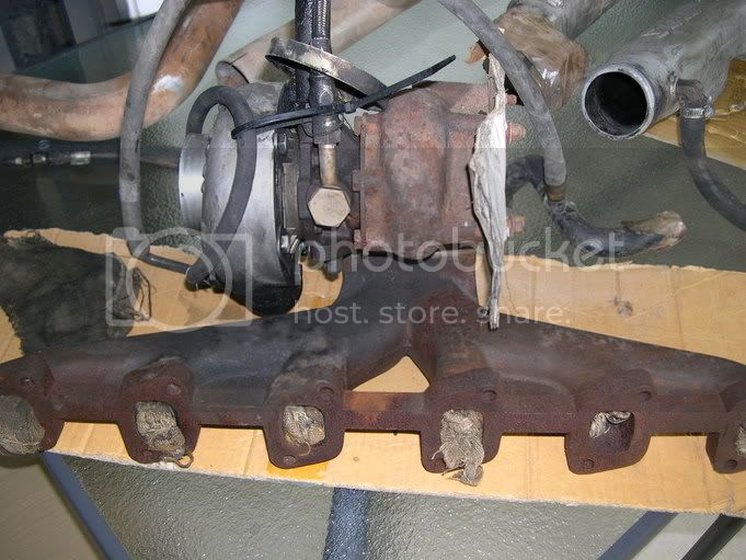

Pics BB posted are identical to the Denco turbo minus the water lines.
