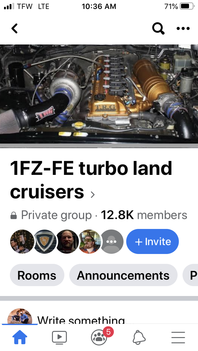

These guys can hook you up with everything you need. Group is full of Aussies.
