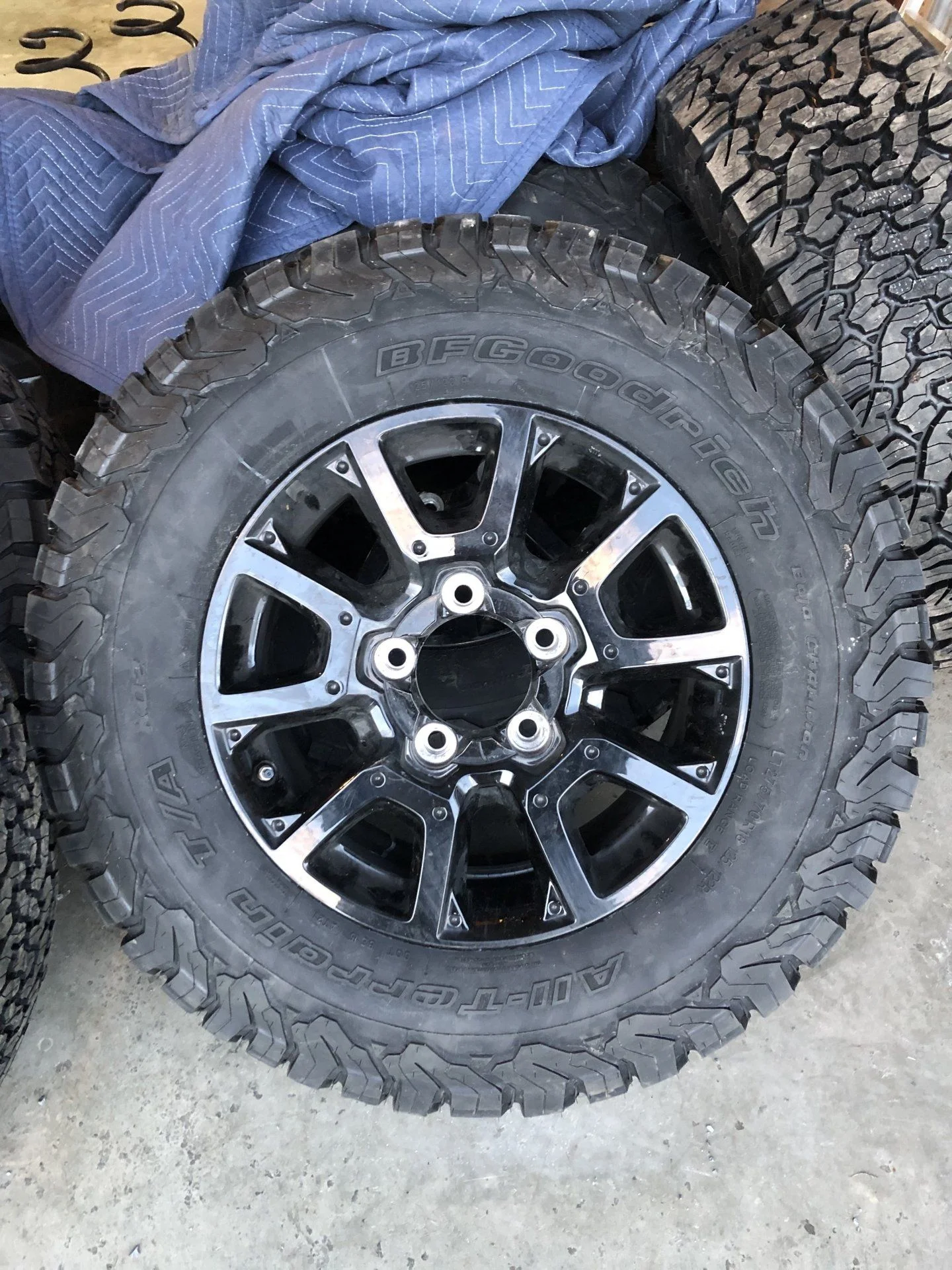

+1 Definitely a powdercoat issue. They needed to mask the inside of the bore and didn't. I run those same wheels (in OEM black paint).
Note the lack of paint on the lugnut mating surfaces as well:
++1 - and they also should have masked off the bearing surfaces on the lug holes.
HTH

It’s good that they did that. I’d want him to address the center bore as well as the lug faces and bores, basically to make it look like the above picture of a black wheel. The faces because that is the clamping surface and the PC won’t do well with that amount of pressure, and the bores because the lugs are a tight fit in there and the PC will interfere with that just like the center bore.
