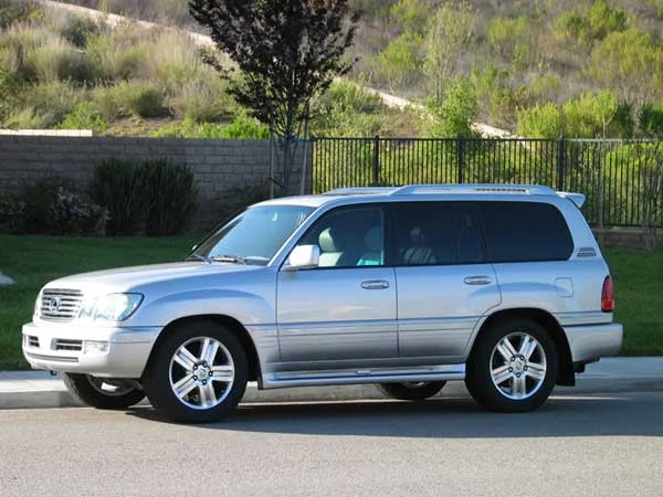

I got some 20s on my LX. Dosen't look too bad eh?

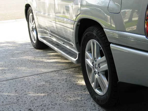

They are direct bolt on. Everything is the same down to the offset, bolt pattern and center bore size.

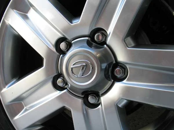

The only catch is the center caps. Tundra center caps fits fine for the rear but is 15mm too deep for the front. If you look at your LC/LX the center cap is domed whearas the Tundras are dished. I'm looking for a solution to utilize the tundra center caps for the front but might require a 10mm wheel spacers.

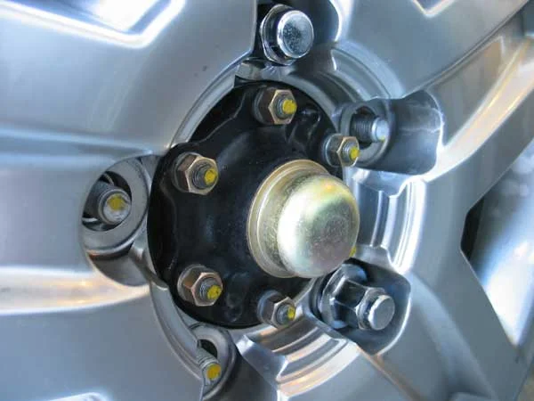

Here are some pictures with the front hub sticking out. Fortuately the LX front caps fits on the Tundra 20s.

These Tundra accessory 20in wheels will require modifications to the wheel to make them fit on front of the 100.
