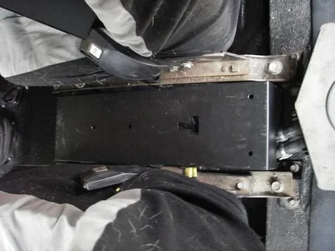

    Mine fit right in with the holes already in place for the back heater hose. However, the years of wear on the original seats had it in a tight squeeze. Then, I backed it up for the stick (I bought the optional cup holders) and it brought it above the back heater. When you tightened it up, it brought pressure to the top of the heater plate. To fix the problem, I just bought some hard plastic spacers and put them in over the plate. Lifted the console so that the fan in the back stopped scraping the top of the incasement. I have the long console with the stereo/CB section.
  18. outdoork9lady
    outdoork9lady
    Messages:
    61
    Albums:
    1
    Likes Received:
    Joined:
    Dec 25, 2006
    Location:
    Livermore, CA
    Here are the rest of the pics
