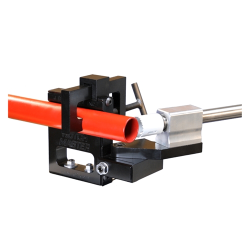

My only experience with one is the entry level JD Squared unit. I thought it sucked.
JD Squared, Inc. - TN-100
That one is only $200. It worked OK at 90° but at an angle it left much to be desired.
I used the JD2 Notchmaster for years with no issues.
C,
I have the same NotchMaster that Stan has. Mine is only 2-3 years old though. I've had to rebuild the T-handle twice. Once because it bent and the other due to threads being chewed up. The internal threads for the T-handle on the horseshoe bracket have stripped out 3 times. I finally welded a hardened nut to the bracket and made a grade 12.9 T-handle and so far so good.
I looked at the Baileigh unit as well but after talking to someone that had it they said the tube grip plates always slipped on anything over 1.50". He ended up taking it apart and filing teeth into the plates to get it to bite better. Now he was gouges in his tube after cutting.
I make up to 200 notches a day when making rack and slider run pieces, 2-3 times a month. So, overall I probably use the NotchMaster heavily compared to most. With 95% being 90 degree cuts on 1" x .083" HREW. I should probably be using a more industrial cutter like the MB3..But VERY pricey.

Where I ended up / JD2 upgrades:
JD2 Notch Master
