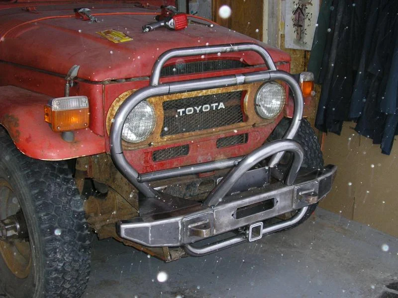

I used a friends pro-tool to make my front bumper - he modified it by putting a hydraulic cylinder on it. It worked well, he uses it at his welding shop for motorcycle frames etc. Here's a pic of my bumper. I'm going to use it for my roll cage, sliders and rear bumper this winter.
awl_teq: nice bumper...a bit off topic but would u mind posting some pics of how your hoop is tied in? i would like to tie my tube fenders/sliders into a front hoop and havnt figured out how to mount everything and i just dont like the idea of welding to a frame when i dont have to. makes everything perminent and with the way my truck is....its apart prolly at least once a year for upgrades/messing around.

Yotawheeler - yeah I'll get you some pics when I get home. If you look at the pic above you can see I used a large 1/4" thick gusset on top of the frame rail and have three 1/2" holes per side to bolt it on. Two of the three holes are in front of the hoop and are the stock recovery hook mounting holes - the third is behind the hoop. The gusset goes past the point where the frame begins to arc upwards - so the gusset has a slight kink in it to follow the frame. There is also a piece of 1/4" plate on the outside of the frame rail with two more bolts. It is welded to the top gusset and to the back of the main bumper tube. The drivers side top gusset will have to be notched for the yet to be installed power steering box - that's why it isn't plated or painted yet. Like you I am planning to tie a fender guard to the main hoop and then on to sliders. I am going to make it come off the main hoop a couple of inches and then have a flange with two or three bolts (maybe 3/8" Dia) so that it is removable and repairable.
So there are ten grade 8 half inch bolts holding it on and the material used in the bumper is as thick or thicker than the frame - I figure it's plenty strong e-nuff. The bumper is just sitting on my frame at the moment with two hand tight bolts so I can pop it off and take a bunch of pics for ya. I'll post them in a new album in my user profile so I don't hijack this thread tooooo much. :D
