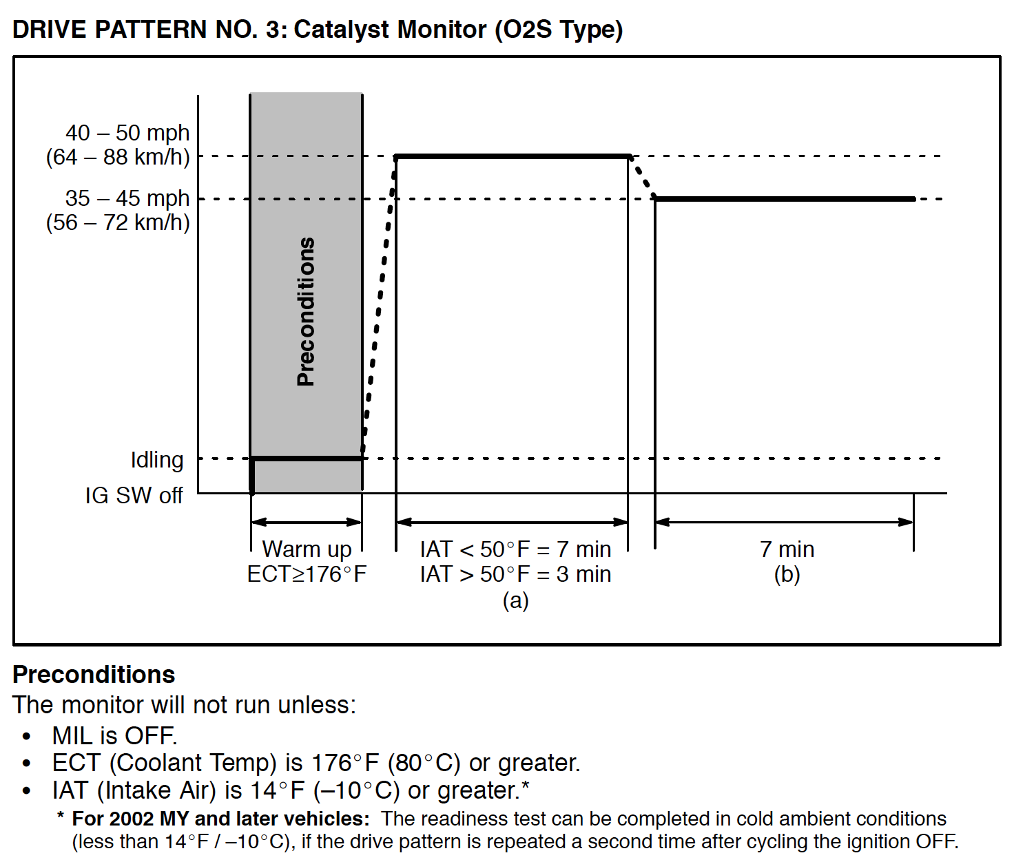

Hi all. We recently bought a 1997 80 series LC from Washington State. Had it shipped to California and had quite a bit of work done on the rig. Been driving it for roughly 300 miles now and the catalyst monitoring status is "incomplete". Everything else has passed. No check engine light. I have my own OBDII tool to keep checking and have tried all the suggestions on this site for the different drive cycles to get the status to reset. Toyota drive cycle to complete OBD readiness monitors | JUST SMOGS® + REPAIR - http://justsmogs.com/2016/05/1996-to-2002-toyota-obd-ii-catalyst-monitor-readiness-drive-patterns/#comments. Anyone else have any other suggestions? The Toyota/Honda shop that did the work for us suggested that we just need to keep driving the car as long as it takes, but the registration is expired and is from out of state and we're concerned about getting pulled over with expired registration. Just would like to know if there's anything specific to consider. The work that was done included
- Replace EGR Valve, EGR Vacuum Solenoid and oxygen sensor.
- Disassemble and performed EGR Port Cleaning Service
- Replace water temperature sensor
