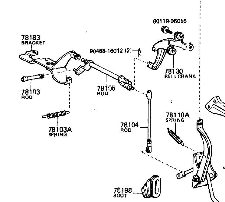

It seems that he cut and polished where the linkage bracket used to be (Jim if you read this, im not pointing fingers and saying you were wrong in doing so, i just have no clue what to do). So my question is, for you guys, what route should i take in hooking up the linkage now?

I don't understand. The linkage bracket is a separate bracket that bolts down on top of the carb base plate using the carb mounting bolts. So what was cut a polished. Maybe post a picture?

so the thing called "bracket 78183" in the schematic above is what you are missing. It slides over the two drivers side carb mounting studs and is held on by the bolts that hold the carb base plate to the intake manifold. The ball end in you bottom picture fits into a socket on the bracket.
So Jim didn't cut anything off...
You need the linkage bracket #78183 in 2MBB's pic above.
