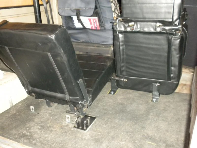

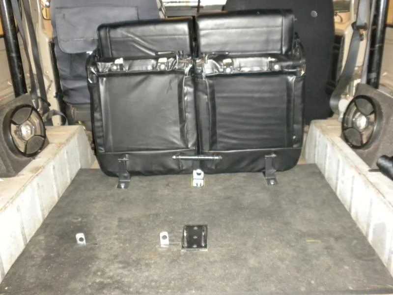

I have to find a welder to install rear seat catch bracket (did not want to drill into reserve tank). I was able to do it in around 5 hours. Call me if you decide to order, I can get you around 20% off. I did some research on them, and the split seat will work great for child and dog. I had my 17 year old 6' sister sit back there and she was happy. I do not envy the person that has to get in and out however, glad I am the driver:steer::flipoff2:

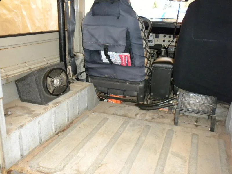

The car seat clips were hacksaw prototypes. I plan on cutting the end off a chain link and welding it to tub. It will be recessed under rubber mat. I was just going to put up a few pics but I wanted to add a few tips in case any body read this and installed the same:
-Study the underside of tub. holes will be made in middle of tub support cross beam.
-Reserve tank? careful. I decided to weld not bolt rear plate. bummer.
-rubber mat (Del's) or a platform of sorts is a must. The ribbed contour of the bed makes the the rubber landing pads uneven, plus it will give you more room.
-seat belts some with some 2" washers.
-shipment took 10 days from Ohio to 4wheelparts in Tacoma.
-The front left and right brackets should be mirrored but they are identical. it is not an order flaw, rather a design glich and easy to work around. (leave long tab towards front)

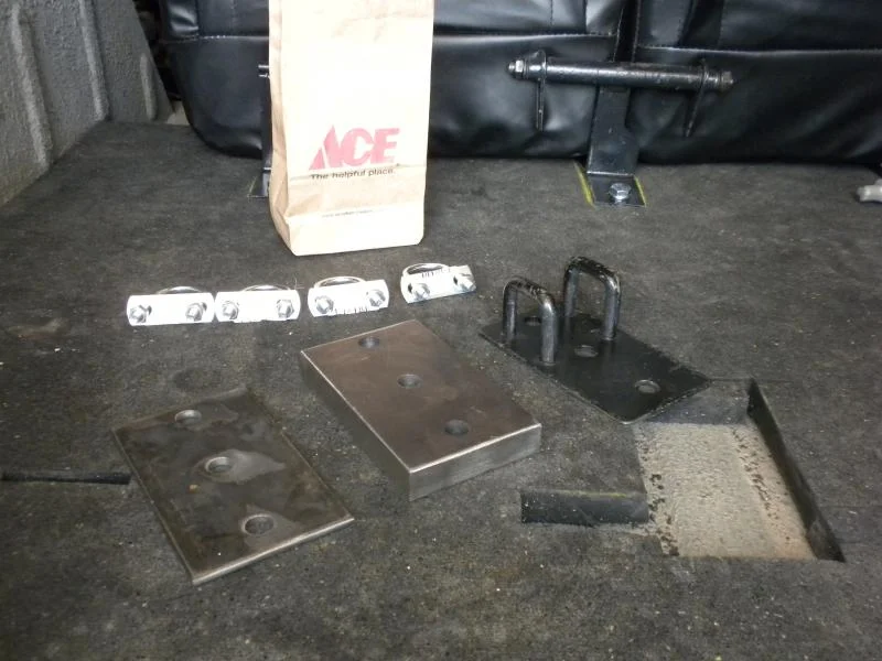

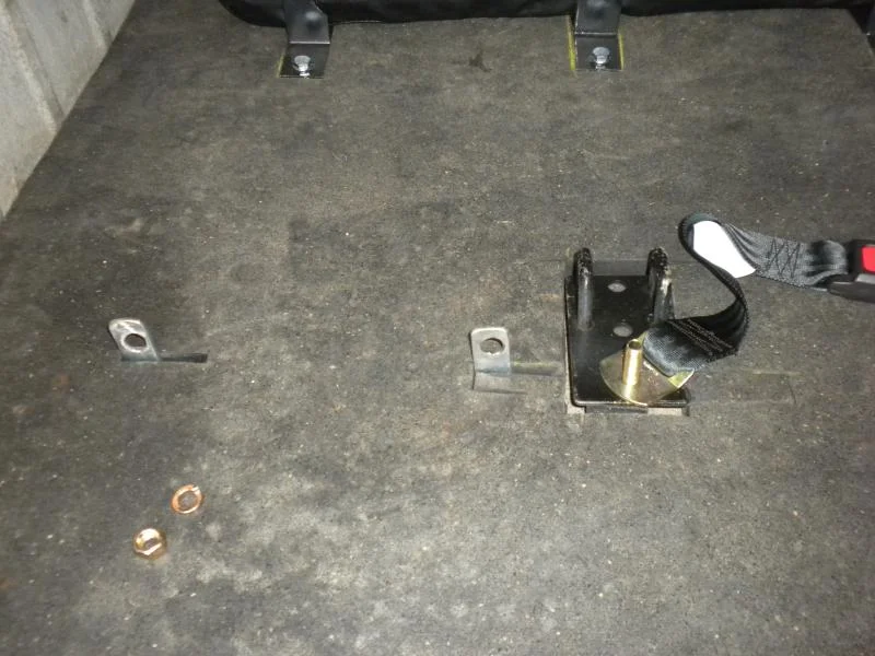

Well turns out tub is too thin to weld to as most of you probably knew. So I had some spacers and brackets manufactured and I will have to drop tank to install rear seat mount.:mad: $20 and since I was dropping tank I'll bolt up the car seat clips too. $5 :wrench:
This last little bit of the story will not apply to anyone but me. Turns out my reserve tank is welded in. under it is my towing packages that is welded in and attached to that is a hook plate that is welded in. So what I have to do now is fabricate a new floor:) another $60:bounce:
