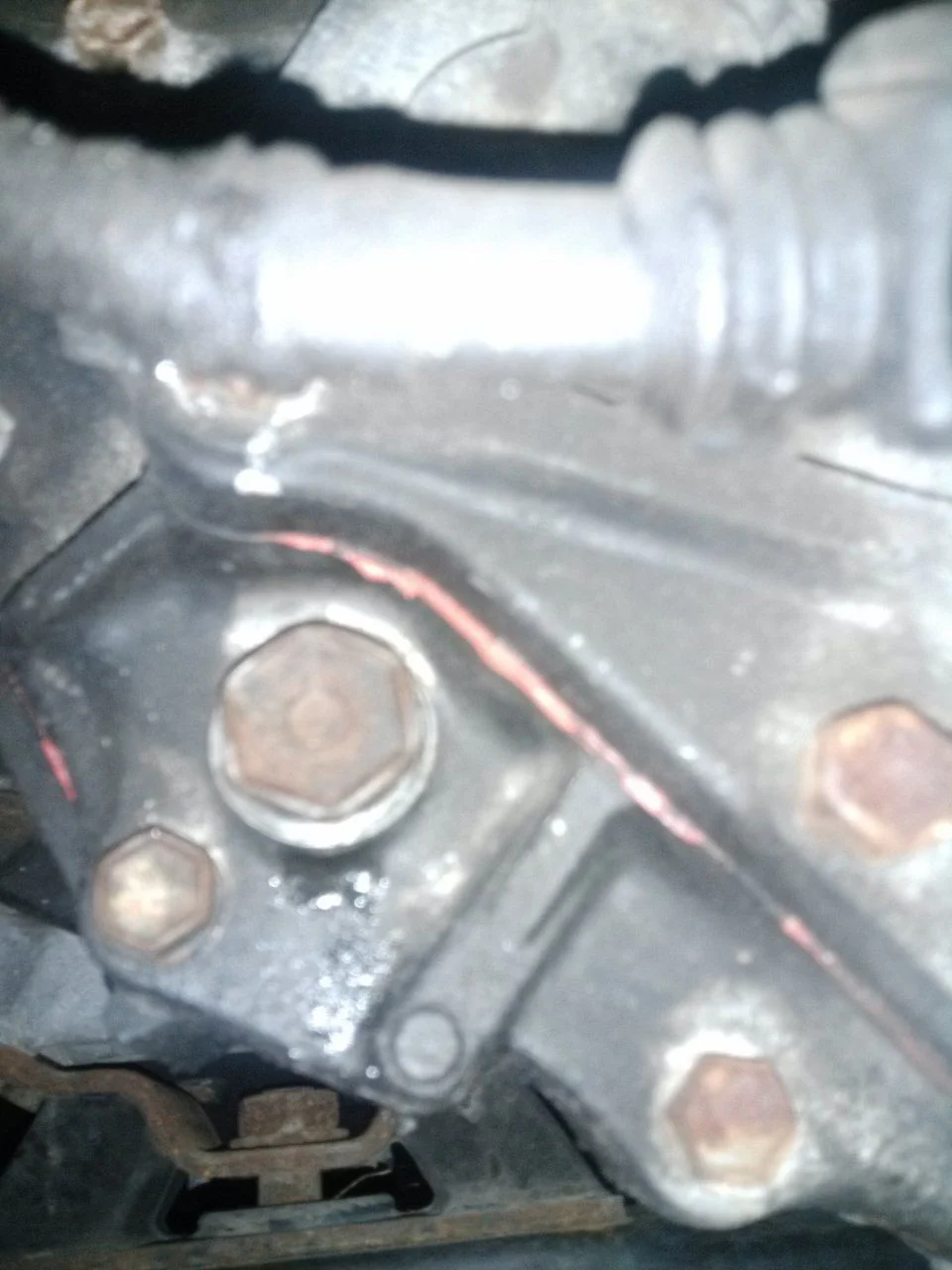

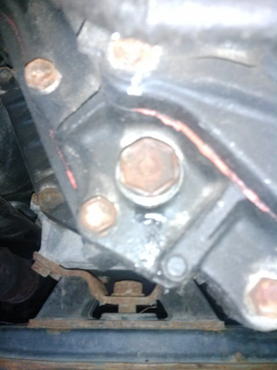

TROUBLE: Stripped fill hole inlet threads on Transfer Case
I don't have a measurable torque wrench................which is why im in this mess to start with.
How much torque you think I'm putting out with my hands and cloth over the bolt/plug haha?
Is this heli-coil kit something i could perform from under the truck. Last thing i want to do is screw it up even more. Is it generally something that shops are familiar with? My first call to an independent shop i mentioned heli-coil and he thought i was speaking french.

Sounds like you have a plan, I guess all the plug has to do is stay in situ and not leak. I'd Initially check the expansion plug for tightness pretty regularly until you have confidence it's going to stay put then check every oil change and drive shaft lube. Probably only going last a few hundred thousand miles :)
id still prefer somethig more permanant for the long run but i'm going to test out a Dorman Help - Rubber Expansion Plug when i get home from work today.
The smallest they go is 19MM. The fill plug on the transfer case is 18MM. Not sure if it will fit or not. If it doesn't fit i will try to lube it up with some gear oil to get it to go in or maybe take some sandpaper and rub some of the rubber off of it if it.
The washer backing is only 22M which is 2MM short of the standard 24MM fill plug backing. I guess that doesn't really matter with the rubber expanding into the threads in the inlet/hole.
So 25 highway miles and 15 city miles later and it's apparent that the fill plug as it sits now (torqued to the point where it will slip/break lose if i turn the ratchet anymore) will not be the answer. It's leaking a very small amount of gear oil. Not enough to drip off, but it's leaking. Maybe 1/4 - 1/2 an ounce. It's more of a seep then leak.
Seeing as vibrations and cold weather will only worsen the leak over time, I'm going to try out the 19mm rubber expanision plug to see if that will hold.................and if it will even fit into the 18mm fill hole at all haha. Need to get the permenant fix done sometime this winter.
