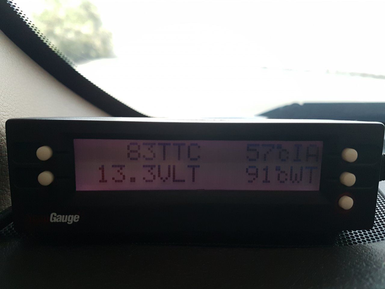

Intake is at 57'c (134'f) with ambient Temps at 40'c (104'f)
Wow, I would not have thought that would be possible, 15c more Mmmm.
Is this always the case or a fluke?
Heat soak in the engine compartment of the air box?
It's hot, humid and I drive a black cruiser. I think you can fry eggs on the bonnet.
The temps started rising when I parked up in a shaded car park, I think the lack of airflow and the heat trapped between the cars and shade contributed, I'll be keeping my eye on the temps the next few days it usually doesn't run this hot you can see the radiator is at 91c as well.
I kept the throttle at 2k rpm for a few seconds and the intake + radiator temps went down by 5 degrees
Got it, black car UAE, nice oven going on while car stationary.
On a regular basis do you see a diff in temp on a regular trip with the snorkel?
Since the snorkel install intake temps have been lower usually. The intake temps are usually 4-7 degrees warmer than ambient temperature.
I'm not sure if it gets the temp readings from the maf or somewhere else.
*a little update on intake temps, temps went up to 60c in afternoon traffic today. That's 20c over outside temps. Driving home at night (1-2am) intake was 2 degrees warmer than the ambient air.
