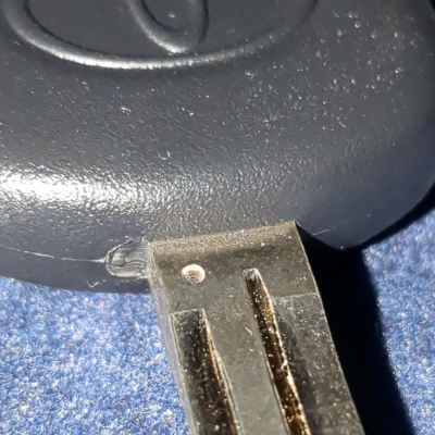

Here is the new master key for reference:
Any hint what would cause a communication failure with a new master key?

Any reason the master tranponder I ordered does not have an "H" engraved, like to original factory master key?
… instead it has a dot "·" ?
... it seems I should have ordered another part number.
For this VIN it outputs
8978552030GRJ71,76..GCC GCC(WITHOUT SAUDI ARABIA)YEMEN IRAQ SPEC&GLOVE BOX-WITH KEY
instead of the key I ordered, possibly at fault:
8978560160GRJ71,76..HT..GCC GCC SPEC(EXCEPT SAUDI ARABIA & UAE)
It seems the 60160 was only from 07.2009 - 08.2010, while the 52030 is from 09.2017 - 07.2021.

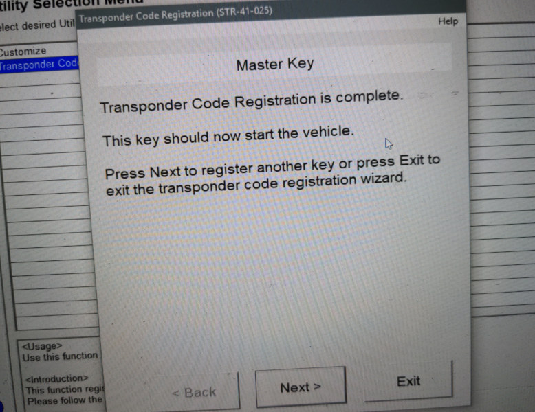

With the right part it worked out beautifully and easily:
