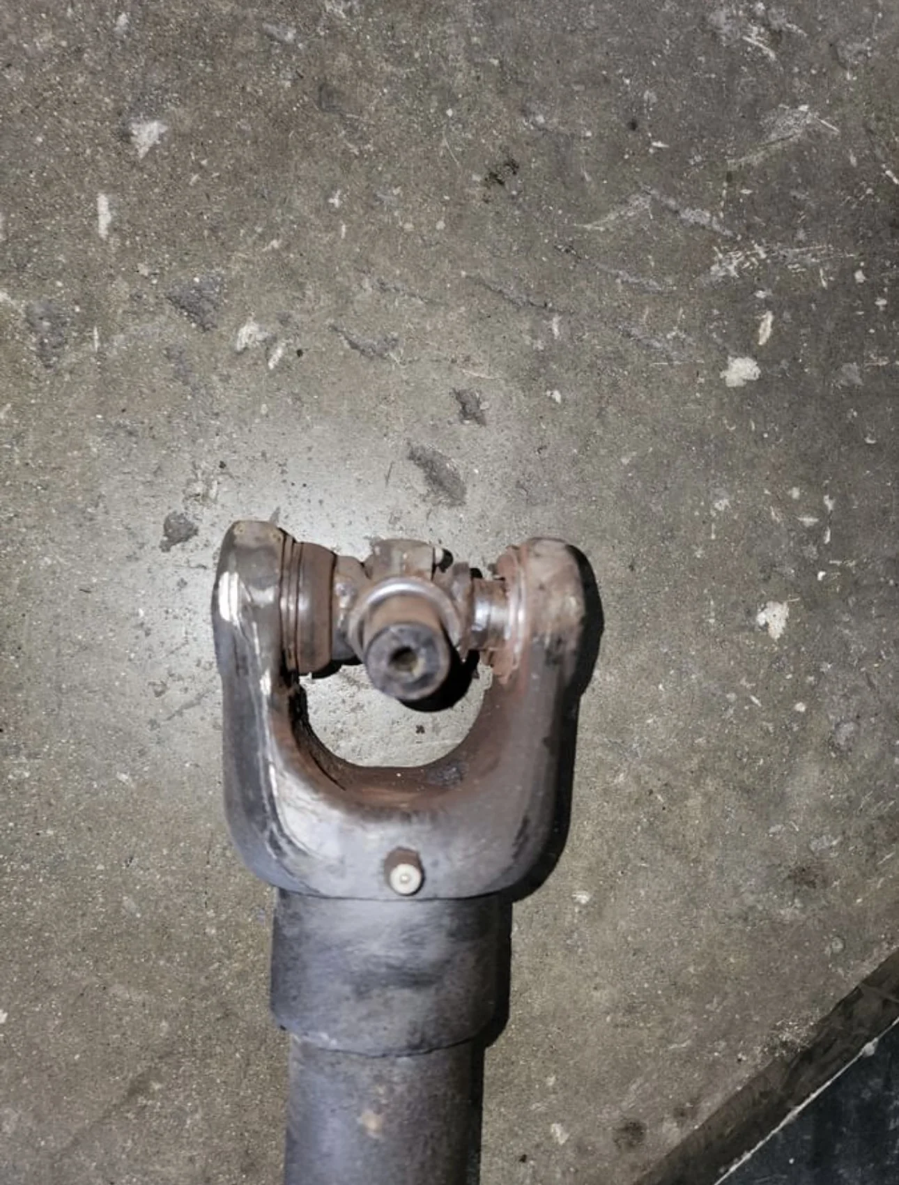

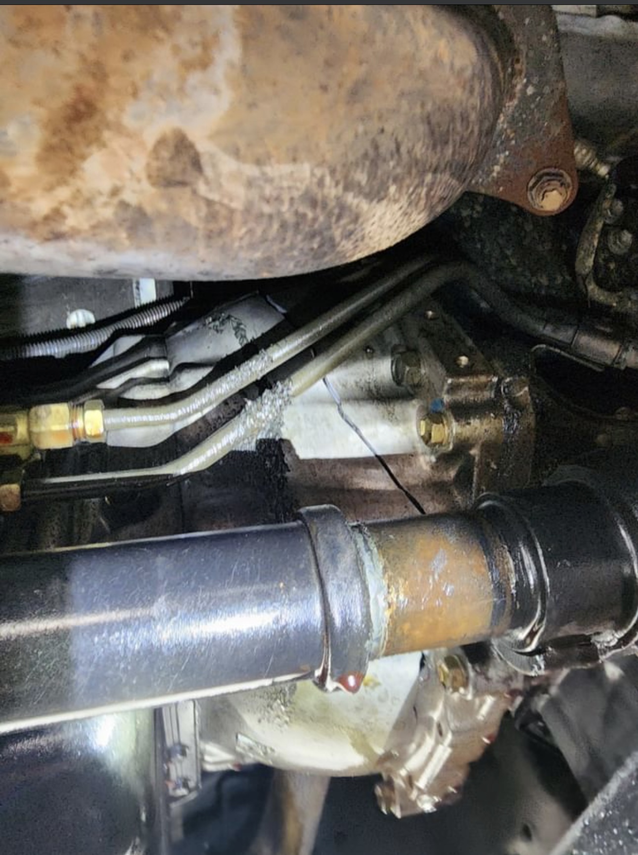

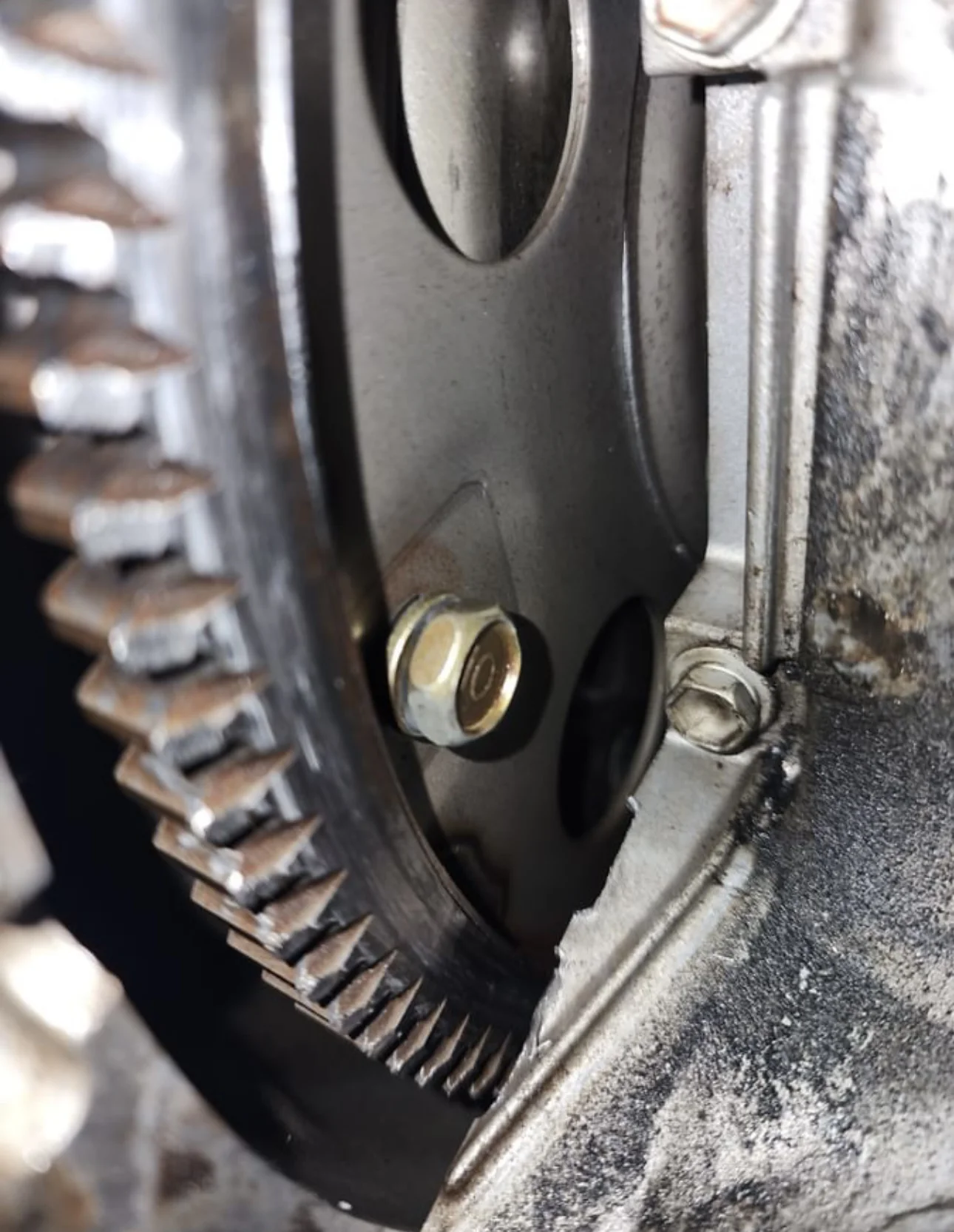

I took it to a shop near me (reputable LC shop) and they said it was the torque converter. My housing split in half and blew the U-joints back into the driveshaft. I always had a bit of a drone in my car before this, and I replaced all the obvious things, including changing trans fluid. View attachment 3871570View attachment 3871571View attachment 3871572
How on Earth the bell-housing got cracked like that.. first time seeing such!
'03 here joining a little late, but I wanted to chime in and put out another reference point of my transmission going out at about 230k miles.
Just a thought about the root cause.
I wonder if the flex plate had been separated from the torque converter at one point and improperly reinstalled. I've seen or heard of strange cases with Tacomas (out of millions sold) where the flex plate was not properly aligned on reinstallation. It appears when the black bolt is not used as the initial alignment bolt. A vibration occurs from misalignment, resulting in a cracked flex plate. If the LC uses a thicker flex plate compared to a Tacoma, moving up the line would be the torque converter. Again, just a thought.
