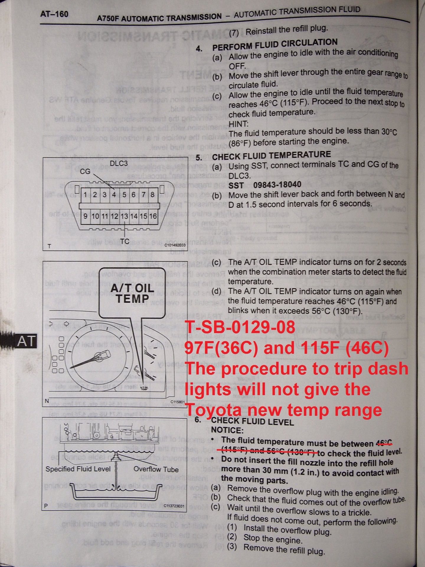

The procedure for jumping to get dash light codes, is not used anymore.
Toyota put out a TSB, whereas we now use a lower temp. So using jump method will under fill transmission.
We now use 97 to 115 F. vs old 115 to 130 f. range.
Some shoot pan with IR temp gun. But I've found that not accurate, but works in a pinch. The issue is ambient temp (OAT), reflected heat and radiant heat can effect your reading.
I use tech stream to read actually temp. In newer models we get two temp reads. One is temp pre cooler, one is after cooler. Watching which temp fluctuates faster or slower you'll know which is which. Pre cooler temp fluctuates faster and is the main body and TQ, so is the one I peg of.
I like to over fill. Than bring up to 97F and pull the check plug while idling. Drain until drips. Than with plugs in, I run temp up to 110 or 115F max, and pull check plug again. If ATF runs out then, I plug fast, without draining until drip. This is just to double check I got a good read on level at 97F. I like running transmission high, so I do not want to drain at the higher temp until drip.
This is from T-SB-0129-08 AFT fluid level inspect.
