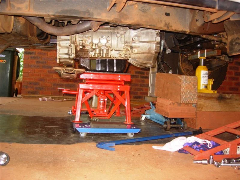

My 1998 turbo diesel 100 series tranny has finally given up. I have pulled it out which was quite good fun and it will be on its way to Rodney for an extreme makeover. 140000km's and my only drama. I guess I got one of the dud Toyota trannies.

Details and pics ? Where did it fail ?

I live in Western Australia way up north so transporting the gearbox 8000km's adds to the cost but all up it will cost me $4000. I'm getting my a442f tranny overhauled at Wholesale Automatics in Victoria. I decided to get the a442f Extreme transmission so I look forward to testing it out. My tranny has been playing up since January but I have only been doing short trips with it knowing it was going to break. I live to far away from any transmission shop to just drive in and have it looked at and in all honesty I wouldn't trust any of the workshops around here with my cruiser.
Hopefully here are some photos
