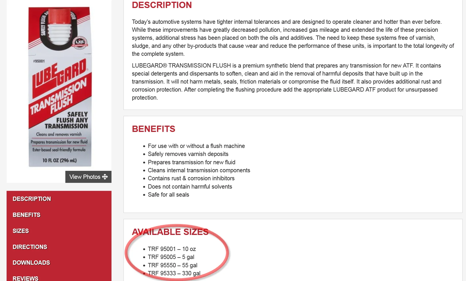

Now this is more like it:
I'm sure a barrel will do the job! Napa seems to have the market corned on everything Lube Gard makes. How have I not heard of these guys before now?
I've used the LubeGard Transmission flush product on two different 80's over the years (a bottle or two, not a barrel). No issues.
