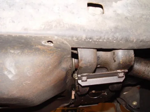

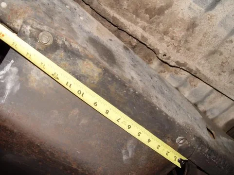

Yes that is the one. I am trying to figure out how far back I need to extend the passenger side so it protects my transfer case. I picture would be great. Where does the front of the slid plate start on the frame?
I hope these help, although my orientation is a bit skewed. Early 1984 fj60, passenger side of the plate:
side shot:
