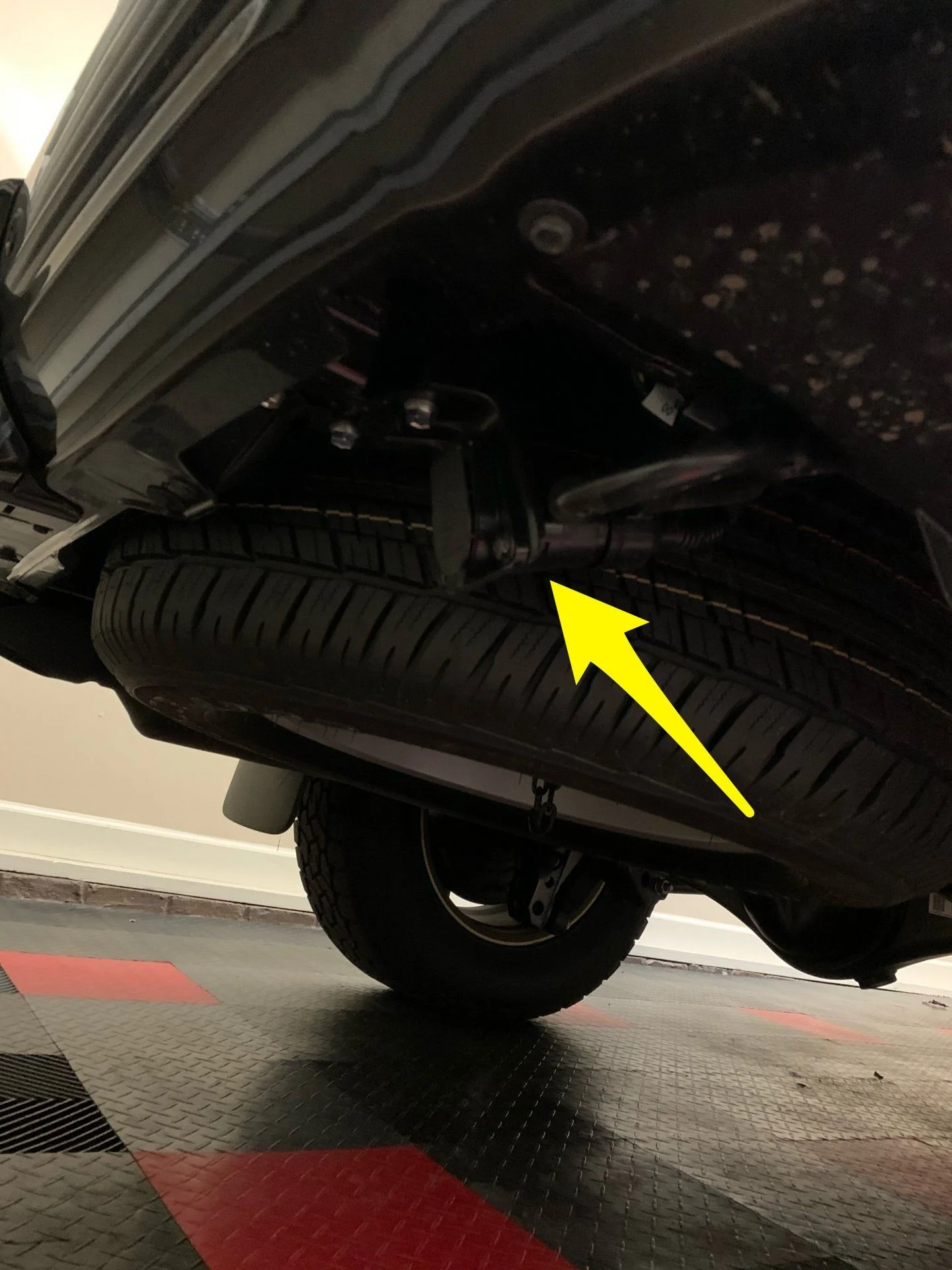

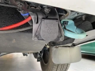

Here it is a picture where it is. Easy access and no crawling under is needed.
No crawling under required. It is easily accessible on the US passenger side of the bumper as shown by the poster above.
Some people complain that it should be on the other side of the vehicle, but I haven’t had any problems. I do have a coiled extension for trailers with short leads that comes in handy sometimes.

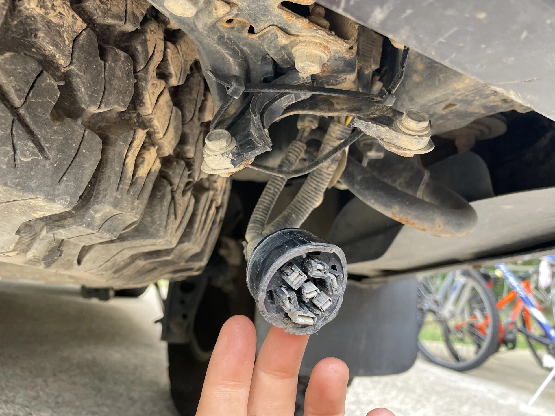

I have trashed my 7pin on a 2013. I need to find the part number for the assembly from the harness out. I landed on it a few too many times.

That’s going to be the result under hard wheeling. As you suggest, replacement is the best option. No real good place to relocate with stock rear bumper. I had disconnected mine from the mount and tucked it up with cable ties behind the frame. Then you absolutely have to crawl around underneath to hook up. It became a pain in the butt, especially in wet/muddy conditions. I think the Toyota engineers have picked the best of the available locations.
Yea I've seen a few crushed on rock ledges before. It's a bad spot but short of it being right next to the receiver (which it is not) there's really no better option on the stock setup.

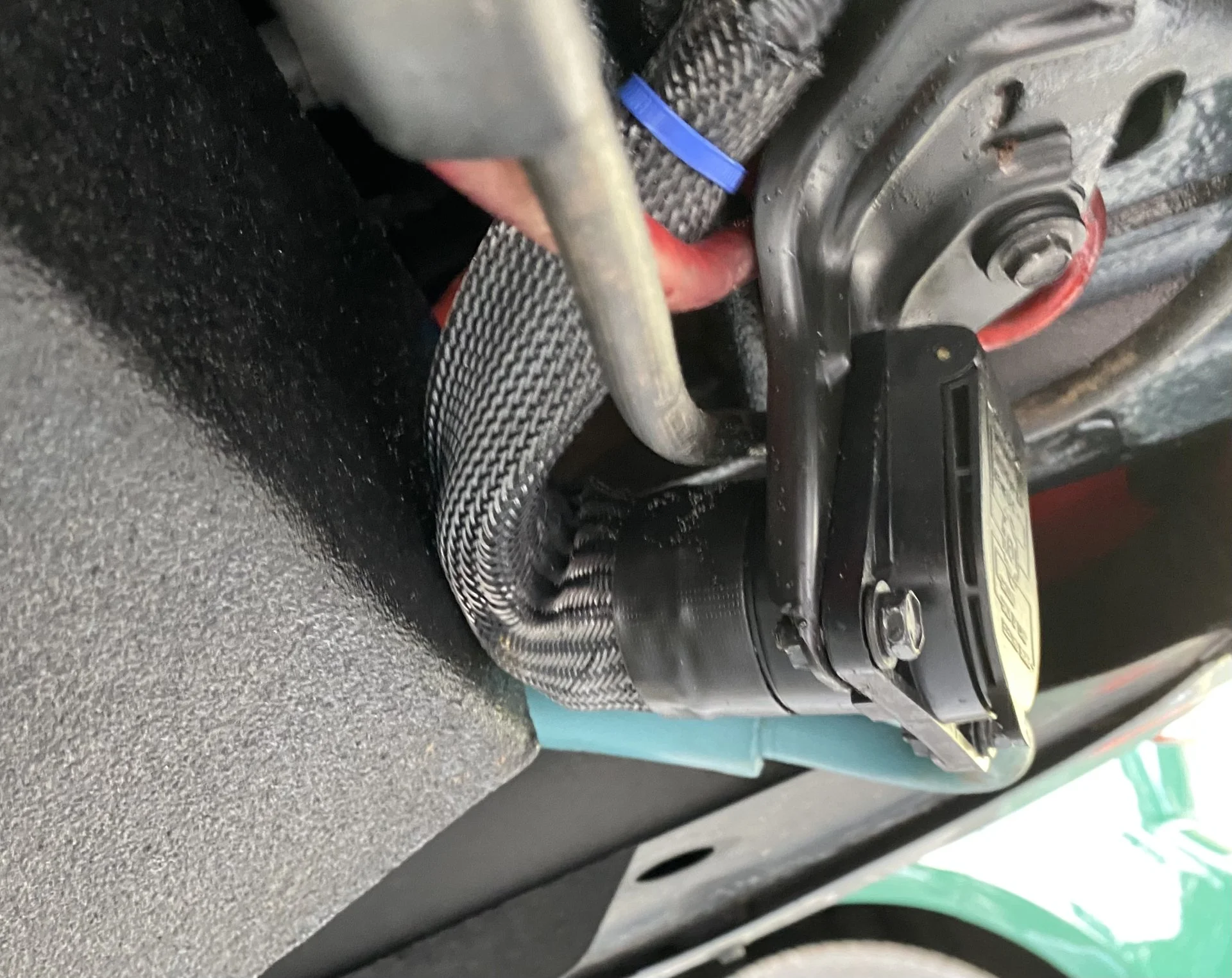

So I had originally tucked the connector as the 40 gal would not accommodate the factory set up. I took off the back of the housing and put a bend in the wires with some additional wear protection/sleeving. I’ll see how long this lasts, the wires look pretty robust. If not it’s wire strippers and 90° connectors.
That looks like it should hold up for the long haul.
