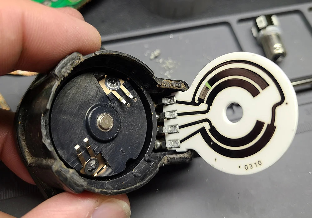

BTW, just for giggles, here's a shot of the guts of a TPS. Don't worry, I didn't destroy a good one. This one tested bad. Not common, but they CAN go out....
