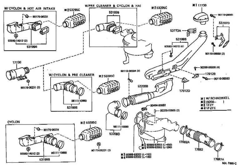

does anyone have the OEM part numbers for the 60 snorkle?
Cruiser_guy wanted to try in Central America for one... I said I would look in the EPC. I looked all over in the EPC and could not find the snorkle.
Anyone know where in the EPC I could find snorkles? Is it under "body"?
There is a diagram here under 2H 12HT even though the diagram says 2F 3B ???
In you epc ,it should be in the same section as the air filter canister
http://pagesperso-orange.fr/adherence_4x4/moteur2H_12HT.htm
OK I see that in those french pages.... But my europe and Japan EPC shows absolutely no snorkles in air cleaner or any other page. I search for at least half an hour with no results.
Must have been another market that got them.

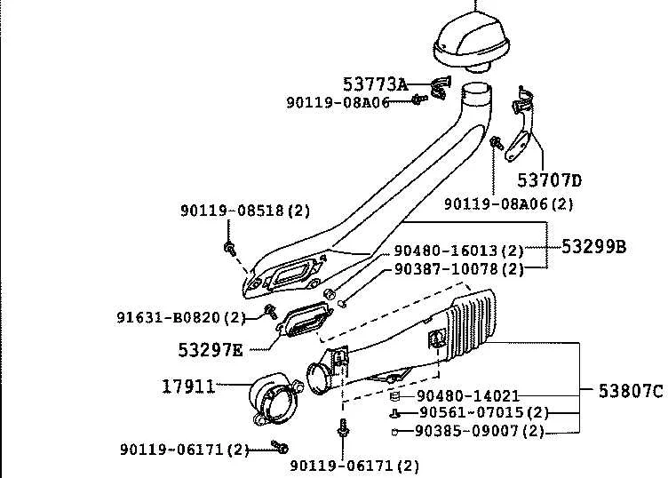

The small image is the 100 unit, it is only listed for the 1HD-FTE and 1HZ engine models. But I see no reason that it can not be fitted to a gas engine model.
The larger image is the 80 snork.

So from the image (for the 80 series) it looks like the part numbers needed to do the whole thing would be:
(main parts and brackets)
17730
53707D
53773A
53199B
17912B
17912D
53208B
53209D
(bolts)
96111-10880
90119-08961
90119-08869 (x2)
93580-19010 (x4)
90269-06006 (x4)
90119-06593
90119-06594(x2)

You are aware that it requires the 10-digit numbers to get the parts, meaning that the "main parts and the brackets" you have stated need the latter half of the PN's.
Anyway, I've started going through my resources in an attempt to get all of the PN's for them. I'm sure Dave(Japan4x4) has all of the info. already though.
