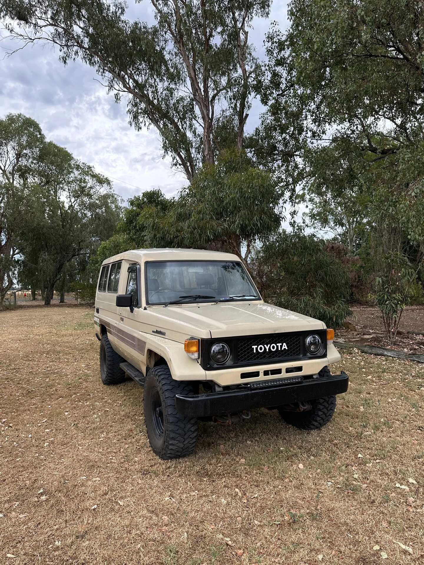

Hello,
Newbie here :) I have a problem with my 1990 Troopcarrier 3F Engine. I’m a troopy owner for two months and recently the car loses revs while parking & driving. It’s very weird just happens sometimes feels like the engine shuts down / loses revs but just for seconds. I would really appreciate any help just starting with cruiser so I have very little knowledge. I can provide a video of it just dont know how to post that :)

This is a pretty huge, wide open range for possible causes to what you are experiencing. From the one picture, it appears that the troopy is well maintained and looked after, so do you have a history of documents or receipts for maintenance?
