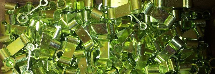

They use all kinds of coatings. And coatings over coatings at times. Cadmium comes in a few different valence-levels that offer varying amounts of high level corrosion resistance at the cost of manufacturing toxicity. Zinc comes in with lower toxicity, but lower corrosion resistance, so other coatings get applied to toughen it up. There are combinations of other treatments that leave you with the dark olive drab color you see on the interior fasteners.

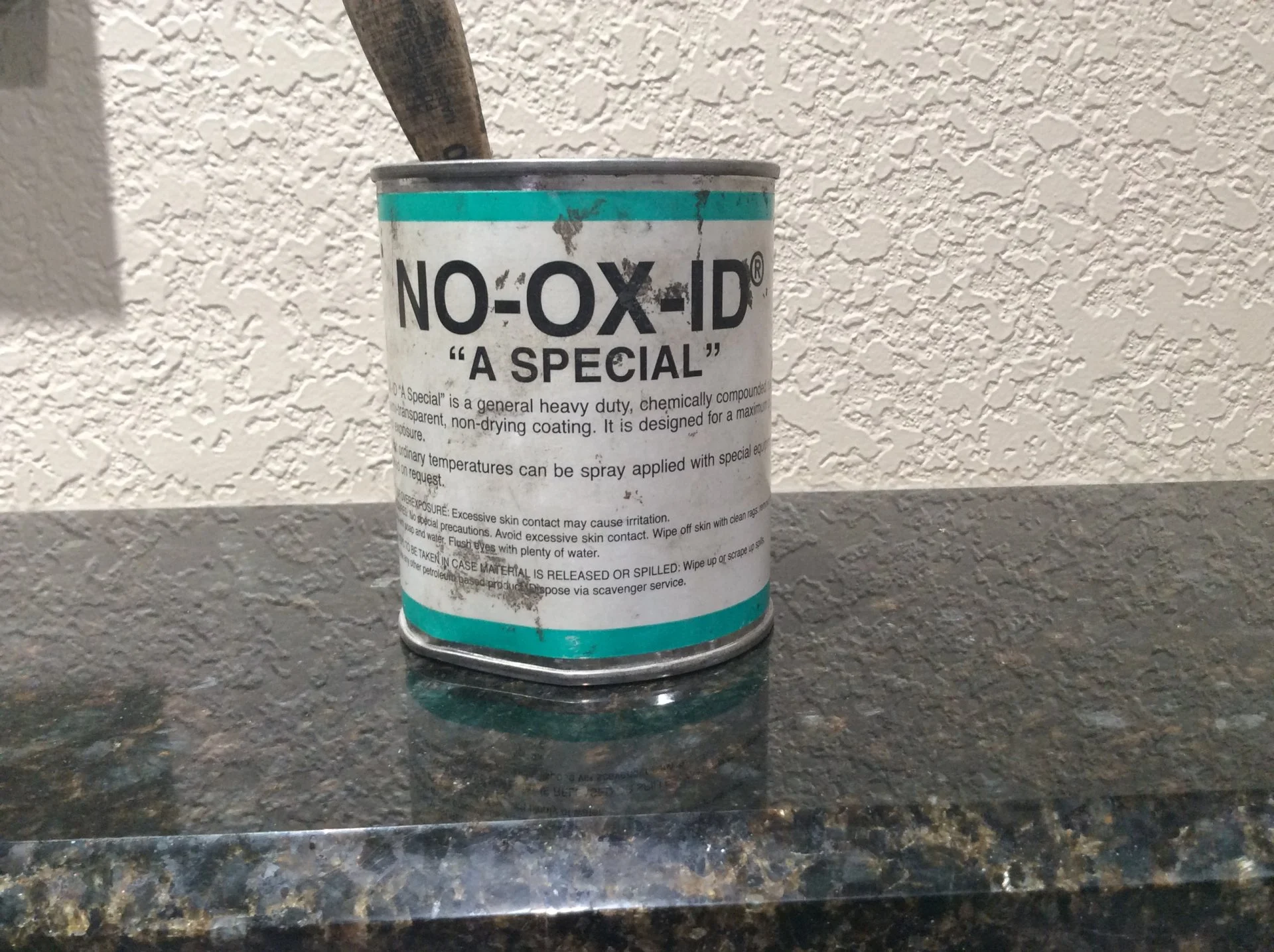

If the bolt / fastener doesn’t require loctite or sealant, I apply this stuff to the threads. Always comes apart with no problem after that. Made by a company called Sanchem,inc
Generally the fasteners that seem to last the longest are the "gold" colored zinc coating with actual paint on them. I usually go after the ones that have been painted along with the body parts from the top of the fenders and firewall. The interior ones lack the painting and are fine but I try to keep those as interior use.
