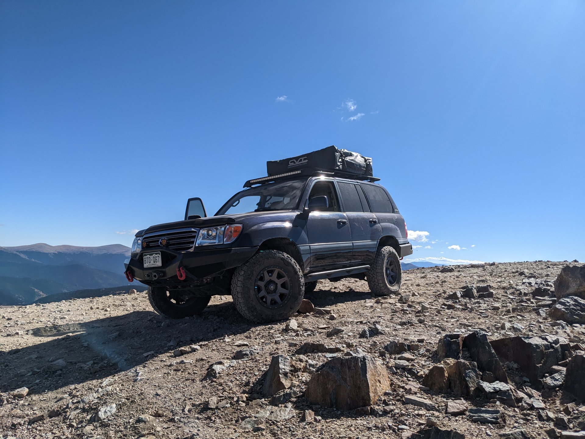

I upgraded to the Toyo Open Country A/T III, 285-70-17 and in the past 2 months I have got 4 flats. All from the sidewall, today was 2. I air down between 15-19 psi for the trails. Today I purposefully took it easy and had 2 flats. Are these tires junk? Is a KO2 a better stronger choice?
Did you get them in E load? I was just about to pull the trigger on a set of these in 285 75 17, but...
Good question. I just checked and it looks like the 2 I wrecked today are C load, however the others are E load. Looks like Discount has 'sum 'splainin' to do

Do you have P285 or LT285?
Yep, one of the reasons that I bumped my p-metric tires to LT, on my DD, was I was tired of the “flats” on urban surface streets. “F” a harsher ride, vs changing a tire in a suit…
I went with Load E and LT tires and have had no issues. Just got back from wheeling good in Moab problem free.
So Discount Tires put a mismatched set of tires on your LC? That's not good!
On a personal opinion side note, the Toyo definitely doesn't have as aggressive of sidewall as the K02. Of course, C rated vs E rated probably played a larger role in the punctures.

Update: Discount Tire let me buy road hazard warranties for all 5 tires even though I only bought 1 replacement from them before this happened. When I came back with these 2 flats they warrantied them and let me pay the difference to upgrade the replacements to Load E's. Really great of them. The shop I originally bought these from, who I don't actually think knew there was a mismatch of E's and C's is going to replace the last C one at no charge, good on them.
