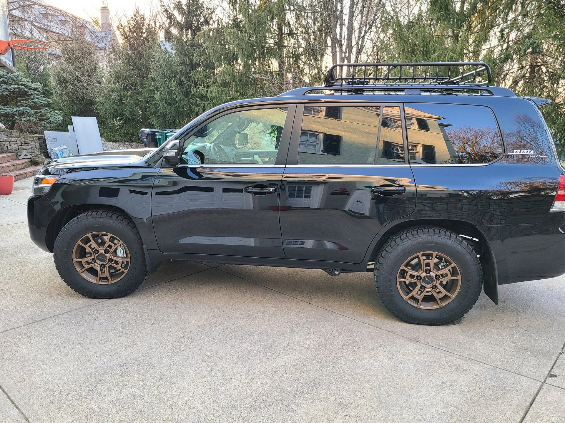

I started this thread a couple weeks back so circling back now. I went with 275/70r18. Cancelled my tire rack order after I was able to source locally at Discount Tire. When I ordered I was told by the manager that they only had 16 of these tires left in their entire system. I don't have enough mileage on these yet for a thorough review. They are not quiet, per se, but I do not find them terribly loud either. No rubbing so far, completely stock set up but need more mileage to rule it out entirely.

Yeah, I noticed they were marginally louder on the highway above 70 mph vs stock but I don't notice that anymore. The Toyos are great tires.

The Toyo Open Country A/T III tires in that size are the LT-Metric LT275/70R18 Load Range E tires. Only because the tires in your pic look a little underinflated, I offer the following:
The Recommended Cold Tire Inflation Pressure (RCTIP) for those LT275/70R18/E tires on your LC200 is 41psi F/R.
Since it's almost impossible to judge tire pressure by looks alone, if you're already at the RCTIP of 41psi, then great. If not, hope you find the info helpful.

Thank you. I agree they look a little light but they are at 41 PSI. You had posted this in another thread which is why I had them put at 41.

Great! Thanks for the feedback - never hurts to check 👍
