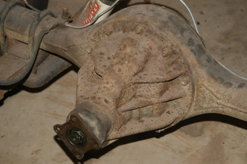

This is the rear differential. If it looks like this (nothing attached to the yoke) then you should be fine. But if some or all of the driveshaft is still attached, you'll want to remove it. You'll need two 12mm wrenches (4 bolts) and probably a standard screw driver to separate the driveshaft from the yoke.
When the rear wheels turn, the yoke will spin, and thus spin anything that is attached. If some or all of the driveshaft is still attached then it will swing and whip it around tearing itself and the bottom of your cruiser up.
